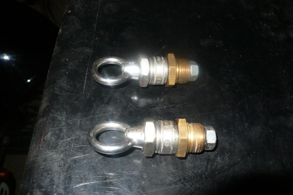

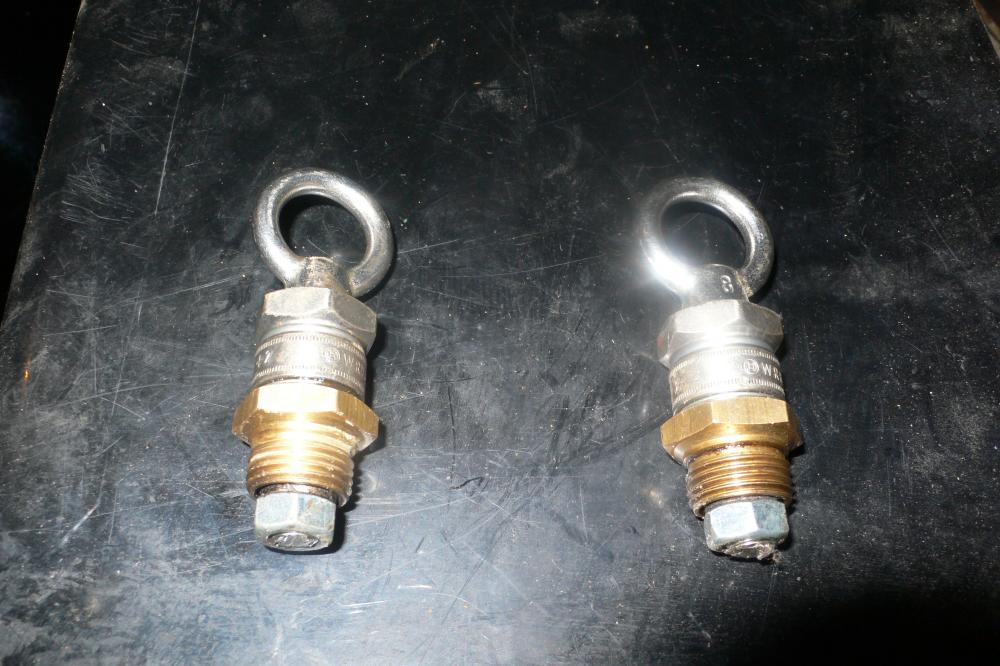

Rob,
Here are two engine eyes that I made without welding. They are made from commercially available 8mm eyebolts fitted to 14mm sparkplug bodies which are screwed into two 14mm/18mm plug adapters. They only difficult bit was, having removed the insulators, having to drill the remains of the bodies to a clearance 8mm.
It took more time to rummage through several boxes to assemble the bits than to make them!
Sorry about the flash scatter!
