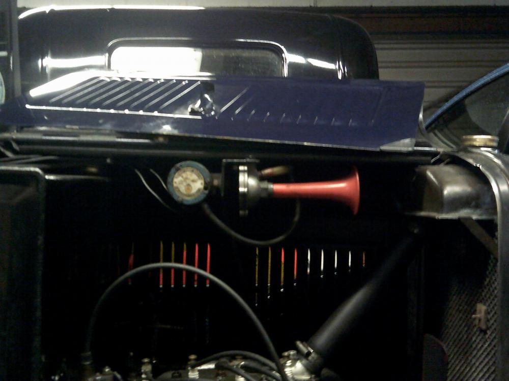

The Benjamin horn on my 12 volt Chummy works well but I worry that it won't last.  Is there some way that I can help it, explained in simple terms?
Convert your chummy back to 6V and the whole thing will be more happy
All you need to do is fit a resistor in line.
(25-05-2020, 10:40 AM)Robert Foreman Wrote: All you need to do is fit a resistor in line.
Agreed!
As resistor one can use a short length (around half a meter, to be tested!) of thin (1 mm) MIG stainless steel wire wrapped on some insulator (wood).
My RL saloon has a Benjamin horn that came out of a farmers outbuilding.   It was given to me in the late 1980's.  I brushed the rust off it and opened it up, the inside was quite good and when I connected up a 12 volt battery, it worked fine.   I duly fitted it to the saloon in 1998 and it has been working well ever since on 12 volts.  in my part of the world it gets used quite a lot.  I have never worried about it wearing out.   Presumably on 6 volts it will not be so strident!
    I found that the Benjamin horn worked OK on 12 volts whilst the Rist horn didn't like it. My solution was to fit a dynamo field resistor in series with the horn. However I found that modern car drivers couldn't hear my Rist horn so I replaced it with the twin air horns father had on his Rover 2000, they hear that.
Thanks everyone, Benjamin and I are now happy.
