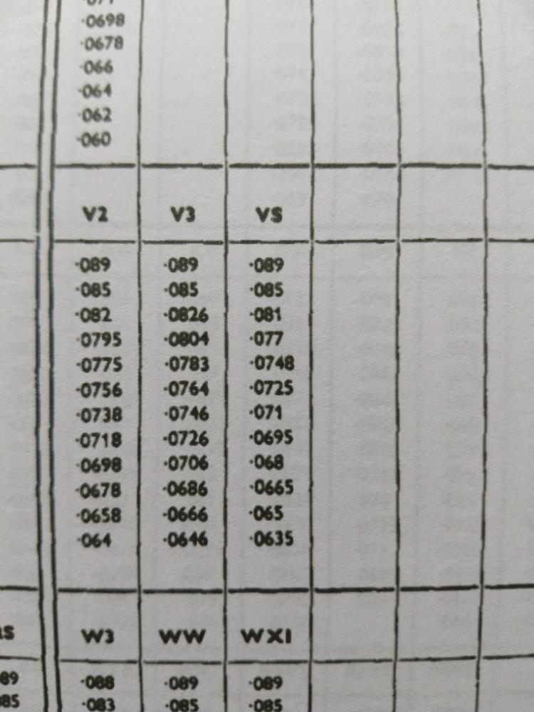

It currently has a VS  needle which looks from the charts to be too rich for a fairly standard engine.

I would recommend using either an EB (Mini 850) or AN (Morris Minor 1000) needle, they are known to work well on a standard engine.
If your needle is too rich, try altering its position in the piston.  Move it out so the shoulder on the needle is about 1/32" proud of the piston.
If that improves things, all well and good!

Don't know about a VS needle but can look it up if you like.

Thanks. I've just fitted an AN needle and will try to set the idle mixture as above when I get a moment.

The AN needle has stopped it getting richer when accelerating. Setting the idle mix as above is still rich according to the AFR meter but perhaps I need to check that against something calibrated!
