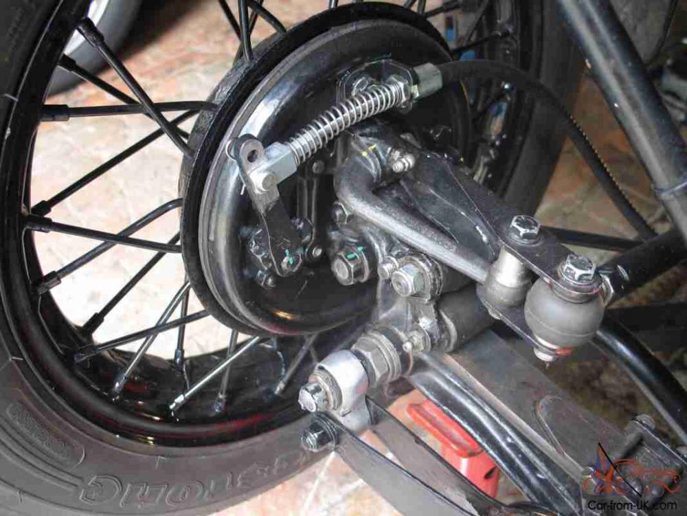

Looked up this John Miles mod, and tome it would slow the rate of turn as the link length , drag link to king pin is increased . Would this possibly reduce the steering lock ?

Hi Peter,
Thanks for posting up the photo.
I havnt found this mod to have any appreciable affect on steering lock. The lower geared steer just makes driving more enjoyable and if you’re pushing it a bit on a winding country road it feels more in control.
Charles
I spent a very enjoyable hour in John's home in Norfolk during which time we discussed how this might be done a little simpler at the other end of the drag link, making the connection on a shortened drop arm on the steering box. I guess you'd run the same risk of running out of travel? I'd bought a set of 15" wires from him off Ebay. It doesn't pay to have regrets,  but I  do wish I hadn't been short on time and a fair trot from home.
