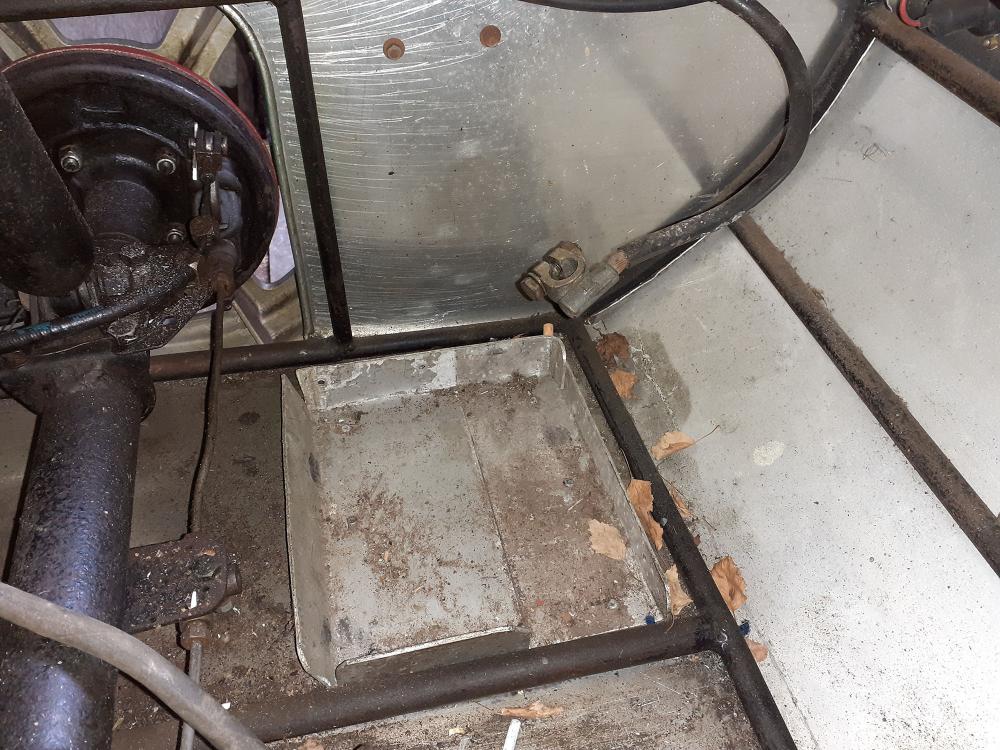

I’m being systematic about assessing whether its historically significant. i.e. was it done when the frame was made in 58-62, or added on to the frame after purchase. All I can gauge is that the project was bought in 68 by last owner, and he has gradually got it together. But perhaps it was an unfinished project in the first place, as the aluminium inside the undertray looks so undisturbed. No decent engine - just a nice useable HC/SU’d two bearing unit from the RN the owner has had since 1960. Last taxed '72. and being renovated off and on since then.

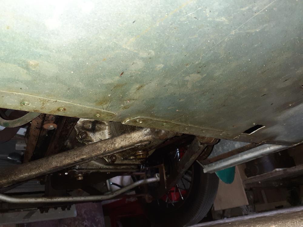

But there are lots of questions - how would you get a rear spring out, or even jack up such a thing, when the undertray and the associated/additional tubular structure means that you can't lift a body off? I am starting to wonder whether, if parts have no Speedex heritage value, would it be better removing the lower part so one can get ‘in’ for its likely future use as a road car - i.e. even lighter. I’ll be grateful for your diverse thoughts as part of my overarching strategy on what to do.
I’m busy ripping out all in the recent glued-in carpets to access the tunnel (screwed) and floor (not quite sure), but it's all rivets underneath…

consider whether the fuel tank is viable long term. i.e. I carry two more petrol cans with the perhaps 2 gallons it might hold?
Consider the undertray with respect of gaining access i.e. for replacing a duff rear spring.
Put dashboard appearance back 15 years from present 70s feel.
I’m not concerned with the engine - if I can keep the car light and concentrate on MPG then it will be a useable reliable car with many of the mods which are being carried with Sevens; i.e. hydraulic brakes, Bowden front axle. I'm warned that the thermosiphon effect on a low rad might not be good without an external pump, which this has not presently got.
? Battery position, whilst nicely made, not good for long cable runs. Could it conceivably be put further up toward engine, under dash or something?
