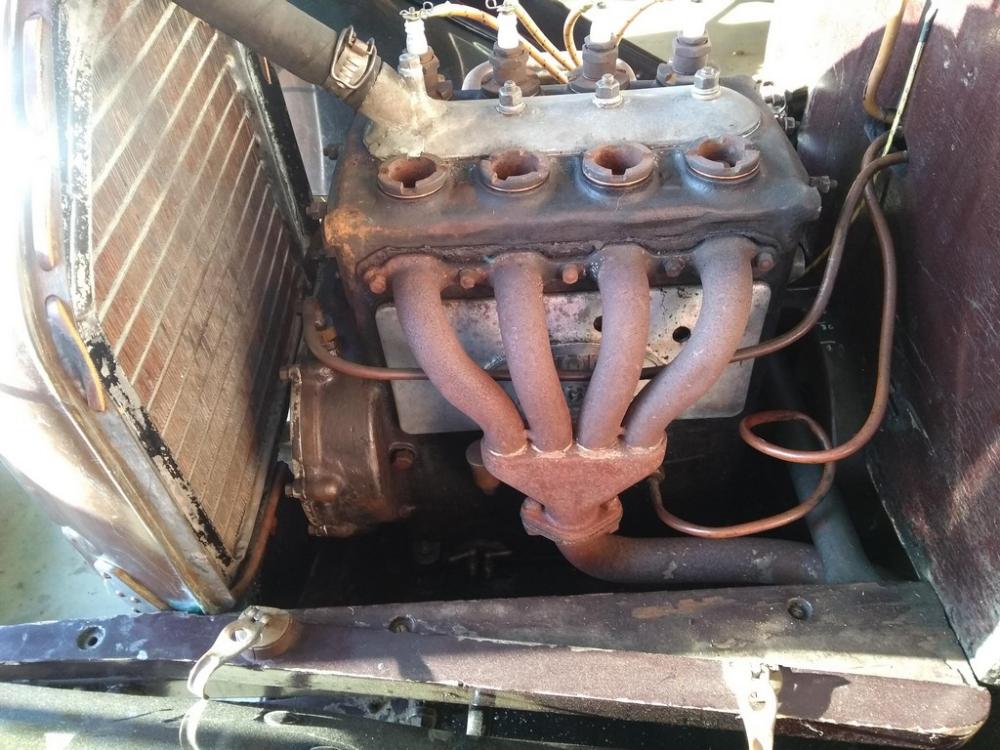

Here is the Bunch of Bananas on my 1913 Bebe Peugeot so not a new idea although no amount of trickery can make these things go.
Mark
