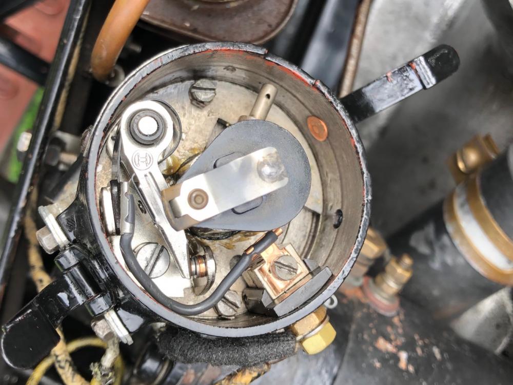

This summer I fitted points from a Bosch 009 distributor (8 quid on ebay), which I am very pleased with. I used a spare base plate which i rotated by about 30°, cut off the tab for the heal of the original points and redrilled to fit. The points themselves needed a bit of trimming to fit, but nothing too difficult.
At the same time I replaced the distibutor with a better one with no slop in the shaft, and this has made a big improvement to the running, much smoother at high RPM. I'm not sure how much of this is down to the points but they are beefier than the original ones with a stronger spring and bigger contact area, so i think they probably help.
Hi Tom
Thanks for the info and modification. I have a couple of sets of spare original points but they are not in that great condition.  I may well have a go at replacing them as you suggest.
Useful info all ---thanks
Will report results when completed
