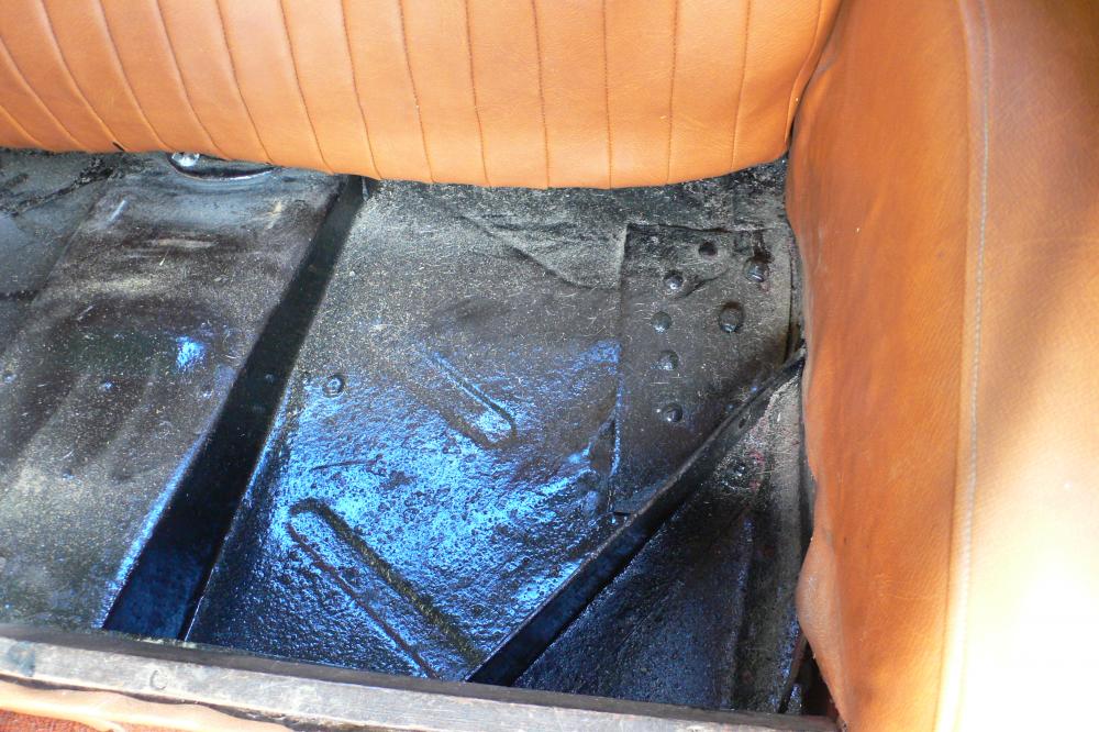

Having drooped my passengers and their dog off at their home, I drove back. No sign of the noise! However, when I got home, I did some investigation and discovered that the driver's side rear footwell is closer to the rear cross member that the passenger's side, which has something like a eighth of an inch clearance. The driver's side appears to taper from the outside to the transmission tunnel; from slightly less than 1/8th in. to virtually nothing.
I am aware that some curiously defective repairs have been carried out to the  floor panels under the rear seat, but these are aft of the rear body mountings. I am also aware that the front driver's side floor has been repaired by the simple expedient of bolting a flat piece of sheet steel in place over the missing section. I also notice that the rear body mountings are bolted directly to the chassis extensions. The rear floor and footwells appear to be original and sound. The battery box has been replaced at some point with a fabricated galvanised steel box which is slightly larger than standard, as the rail that holds the hinges for the driver's seat is about an inch further forward than that on the passenger's side.
I suppose that, in an ideal world, the short answer would be to replace the whole of the floor pan, but I can see no way of doing this without demounting the body and I don't see the point of getting into what will probably turn out to be a full-scale rebuild, given that the body generally is qute sound and the doors open and shut satisfactorily.

Photos of: 1 and 2 The rear floor repairs under the rear seat
3 and 4 The underside of the car where the cross member runs under the footwells. Photo 3 of the nearside. Photo 4 of the offside.
