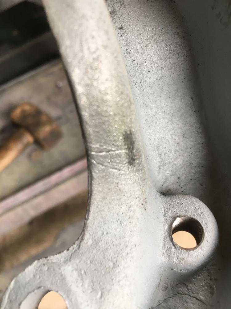

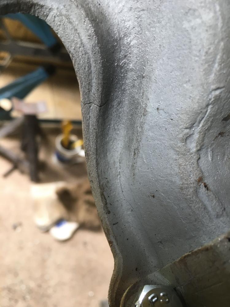

Hi All
I have found a small crack in the nosepiece of my 1929 chassis.
The pictures aren't too clear but the pencil mark denotes the crack's extent.  There are a couple of scratch or foundry marks close to it which confuse things.
Since the photos were taken I've drilled a 2.5mm hole just beyond where I think the crack ends.
Now.... can this be repaired or is the nose piece scrap?
If its the latter does anyone have one I can purchase?
Hi Howard,
There was a debate about the nose piece on this forum not so long ago and whether it was a casting or a forging. I think the jury's still out on that one.
If it's a forging - and that would be my guess - it ought to be a fairly routine job to weld it up. It's a job I'd be inclined to give to a pro, given the thickness of the material if nothing else - don't go dabbing at it with a mini-mig.
If it's a casting, then it's still possible to weld, but you are into rather more specialised territory and you really want to go to a specialist in cast iron welding. That will be costly.
I'm not sure if the nose piece on a '29 is any different from any other A7 chassis, but they do show up at autojumbles and on eBay now and then, salvaged from rotted frames. I imagine it's a bit of a job removing and replacing the rivets soundly. But if the welding does go bad don't despair.
I hope that's some help, also that someone more knowledgeable than me will say something more helpful!
Oh yes and +1 for drilling a crack stop hole, but personally I would now get the crack welded shut.
its steel. Cast or Forged is irrelevant. It'll weld fine
I'm 99% confident you are right Hedd, but is that based on some sort of evidence?
They weld beautifully but thats all I can tell you.
yes. cast steel welds just as easily as any other type of steel.
