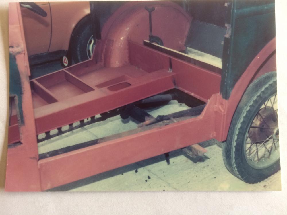

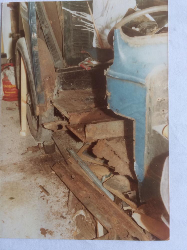

Here are a couple of photos of my RN  which I assume would be about the same as the RP.
And the new sill afterwards, note I welded instead of riveted !

Hi Bob 46320, Thanks for the pics.  Wow that's some job you've got there.  When is the finish date ? Big Grin   Looking good as far as you've  got.  Keep up the good work.  Cheers
The hard work is all done.  Mind you,  it took me 25 years and bringing up a couple of children, building 2 garages and moving house 3 times sort of slowed things down somewhat.

An incredible effort. I would think twice even if it had been a Bugatti.  The common advice to leave on chassis is well founded! The biggest problem would seem to be the A pillar and post, all in view. How did you sort that without donor sections?
