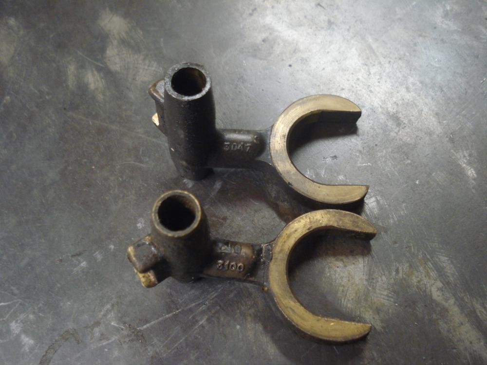

The selectors need changing Rory, pretty simple if you have the parts I can post photos if need be but sure you can work it out.

Ok will take some today for you

This is very helpful - thank you Ian.

25
Location: Auckland NZ
