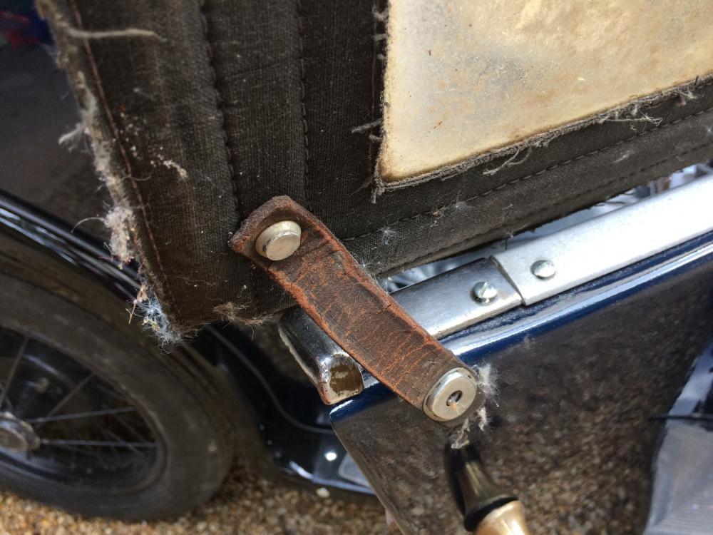

The strap for a LTD fastener seems to be at the rear of the back section of the front door sidescreen. However I can find no sign of where the studs should go!
When the screen is fully in place should there be a LTD stud on the inside of the door & when it is folded forwards, one on the outside of the door or (as on my AD) on the "A" post?

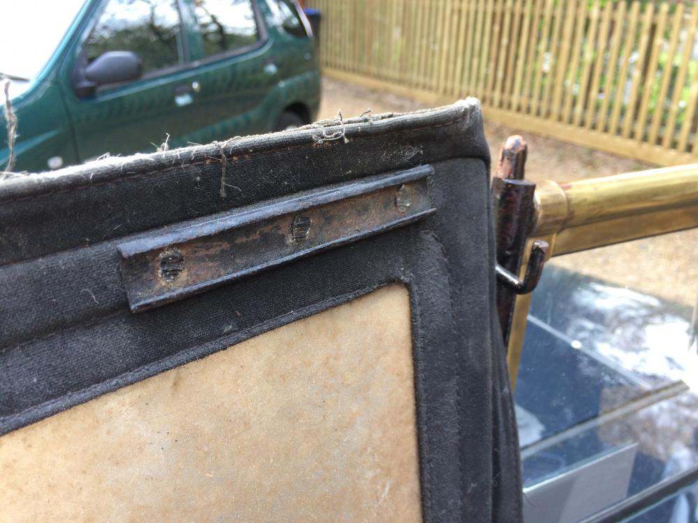

What is the Track on the inside of the top of the front half of the screen for?
What are the "wire" L shaped hooks at the top of the screen pillars for?

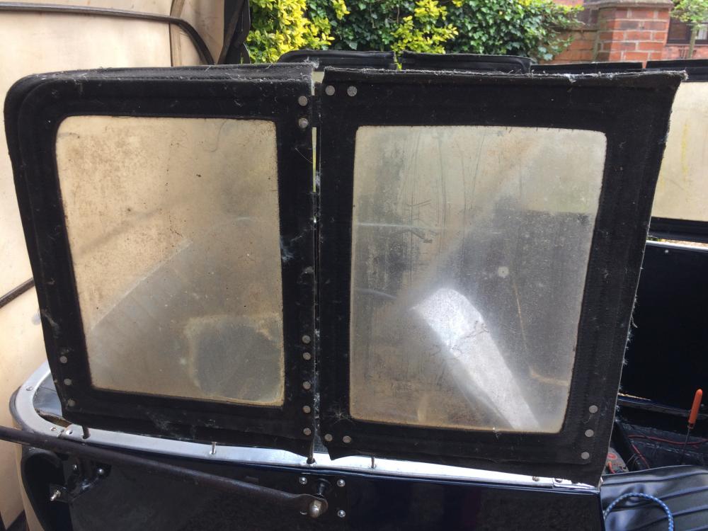

These screens are possibly originals
You have your front side screens fitted on the wrong sides David.
The track should be on the outside of the screen and takes a sliding section with hoop that fits over the the wire brackets.
Willie at ARP stocks the sliders if they are missing.

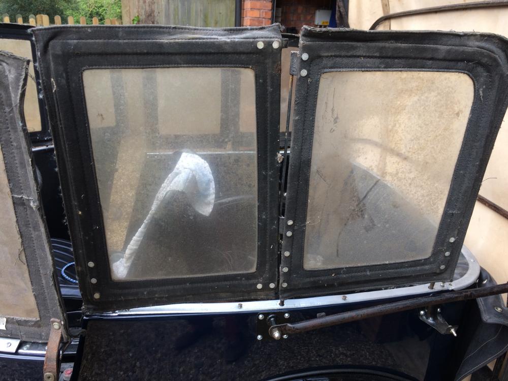

So, the hinge is on the outside? I tried it that way first and it didn't look right. Are the rear ones also inside out?
I still don't understand what the hook and the slide (?) are for!

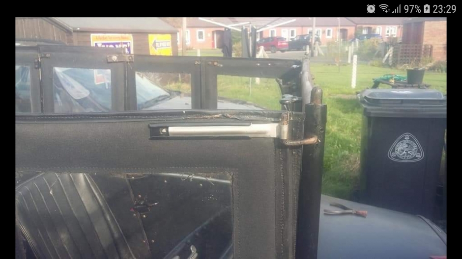

[Image: 008_1759.jpg]
Thanks! So that is what it looks like!
Now....where do the male LTD(s)  fit? Is there one on the door or the hinge post & the other inside by the door latch?
Hedd - you seem to have a strap connecting the tops of the front & rear screens....mine are definitely at the bottom left inside, or if the screen is folded then bottom right outside!
