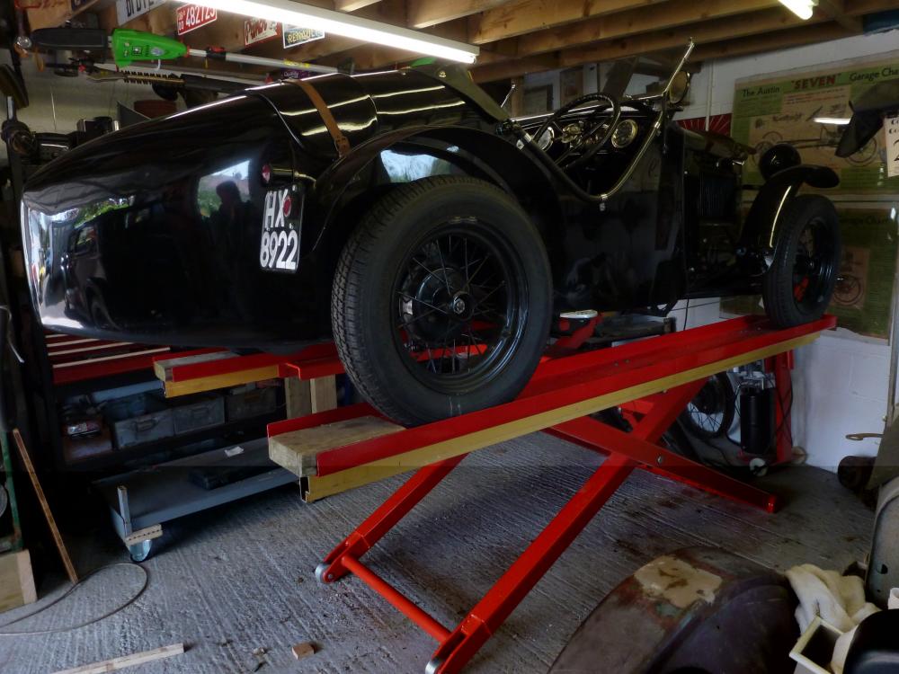

I've bought a scissor lift earlier this year. I fitted channels to it to drive the car straight on.Far easier to work on,and no more crawling on your back.Well worth it.

I also made a cross beam that hooked onto the edge of the channels and used a scissor jack and wooden blocks to raise the car off the ramp.
Access underneath is pretty good for 1/2 of the car, the ramp will raise to 1.2mtr,not high enough to stand (High enough for an open car to clear the upper floor)but ok for a trolley to sit on.

Photo of ramp.This is the standard width one 1050mm or so.Purchased off Ebay SJR garage equipment.He does have some made 900mm wjde if you want to use the outrigger arms as the original ramp.
