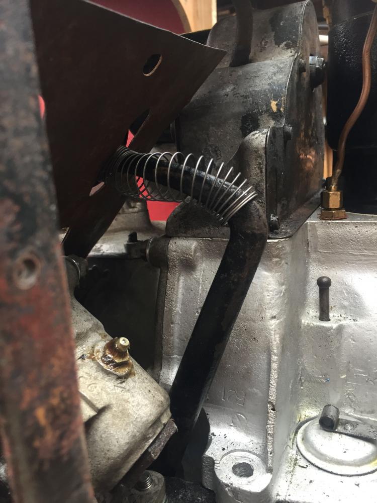

When this happened to me I made a little tab that fitted on the little bolt that holds the oil filler (on a coil car), found a suitable tension spring, and fitted it between my tab, and a large key ring 'ring' that I slipped over the pedal. It sat quite happily in the 90 degree bend in the pedal.
The spring is essentially to hold the clutch bearing against the toggles. You really do not want them coming out. Trust me.
The spring I have to hand is not ideal, but you get the picture...
