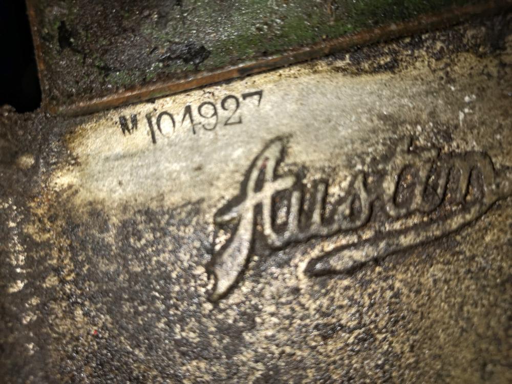

Mike,
This is the number. The starter motor is not in the car, but it would appear to have faced into the engine bay, towards the radiator. I can check later.

That certainly looks like a 1930 crankcase.
