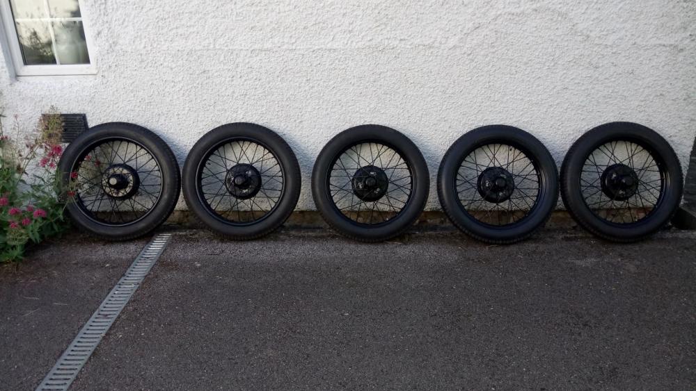

Before our holiday, I collected the wheels from the metal treatment place. The PO had re-spoked the wheels thirty five years ago but then skimped on the painting, and fitted them with remould 4.00 x 19 tyres! I stripped off the (by now rotten) rubber and had the wheels grit blasted and powder coated. I acquired 4 tyres on eBay a few months ago, the vendor had a Russian motor bike and chair outfit with 3.50 x 19 Triple Duty tyres. He'd decided to change them for something more robust and was selling the used tyres. One was unused, two were near unused and one was about 2/3 tread. I bought another new one to complete the set and put them in the attic.
Fitted them this afternoon, boy that was a hard afternoon's work!
Funny, I remember doing a full changeover of tyres years ago, 5 off, another 5 off, 5 on and another 5 on. All in an afternoon! Now I'm sitting here, nursing my back after just doing 1 set!
Age huh?
BTW, bought some professional "Tyre Cream" instead of using washing up liquid. Seems to work OK and provided easier fitting but it does make a mess and it's quite difficult to wash away. Best plan seems to be to remove most when the tyre has been fitted, then leave it to dry and then polish the residue off.

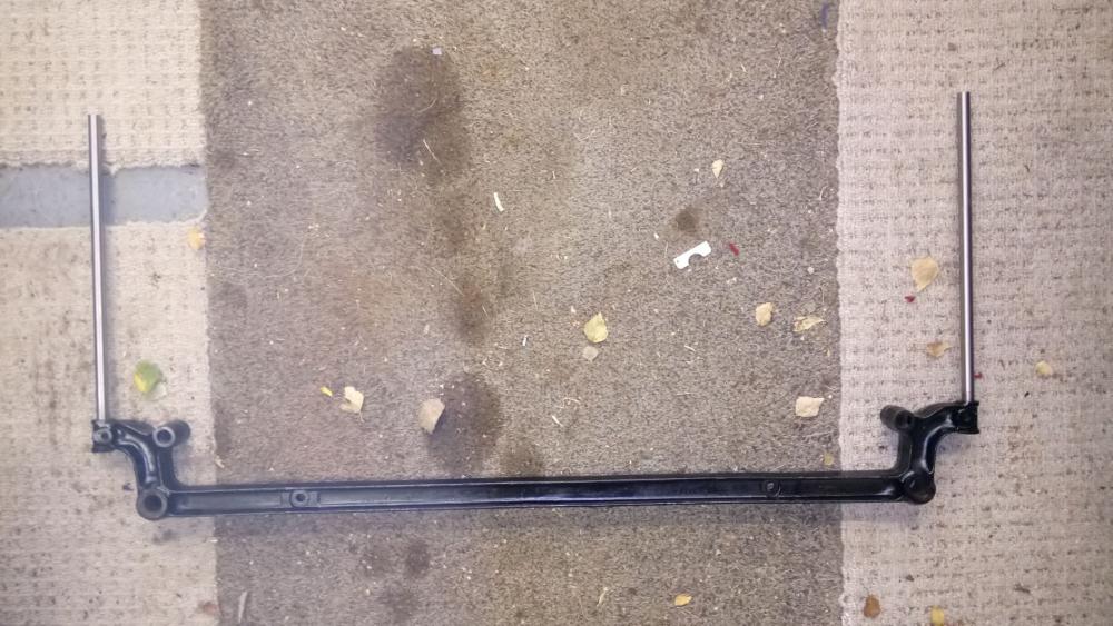

First job was to measure the axle and find out if it too, was bent.

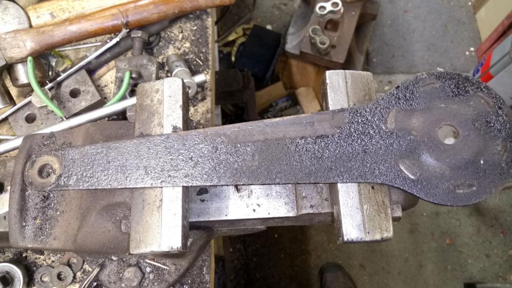

All looked good but the track rod was bent, as were the track rod end levers. I managed to straighten all of these cold by using the press and the vice but the steering lever from the O/S stub axle was a write off and couldn't be straightened. I used another, after crack testing and filing it smooth.

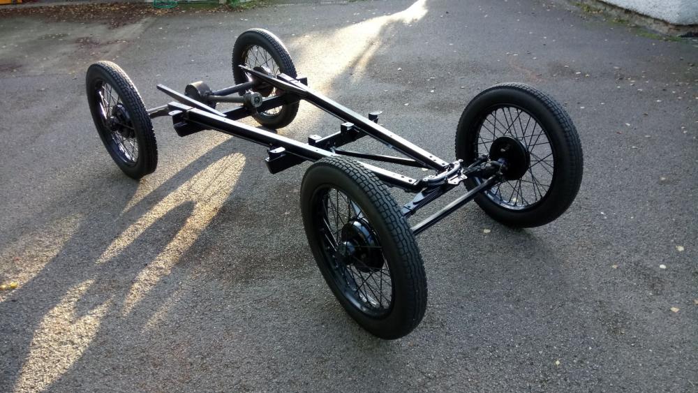

Now, the chassis is back on four wheels and rolling!

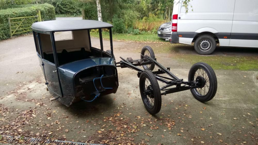

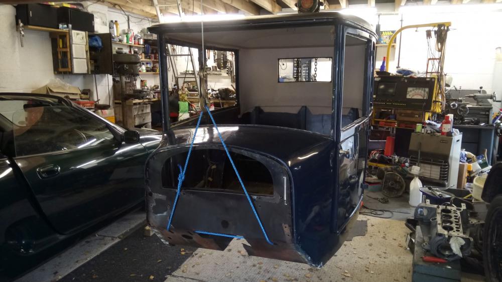

Time for a trial fitting and winter storage of the whole project But how to get the body on the chassis single-handed? (the wife was away remember!)
Here's the answer:
Rope the body up and hang it from the roof! Fortunately, it's not very heavy, I would estimate about 100lb (60kg). Then push the chassis underneath:
Finally, a few bolts in to check the alignment. It actually lines up almost perfectly, some minor adjustment will be necessary but it's pretty good, considering what's been done to the chassis.
Last job, car was pushed out of the garage and back down to the shed, where the it will lie until I get some floor space back next spring. I will be getting on with the engine on the mean time so more to report when that comes apart.
Looks like a car again but mustn't get too excited as it's all got to come apart for floor repairs next year.
