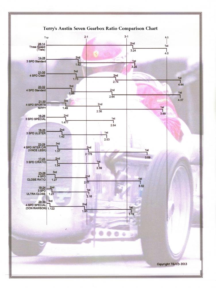

Simon fitting different ratios you change the first motion shaft (input gear) and the front layshaft section so you need to remove the bush to remove the circlip behind
          it to dismantle the layshaft assy. Gear ratio chart attached.
Very handy chart, thanks for that. I find it cool that with the box apart I can see exactly how it works and how changing one gear set affects all the ratios.
