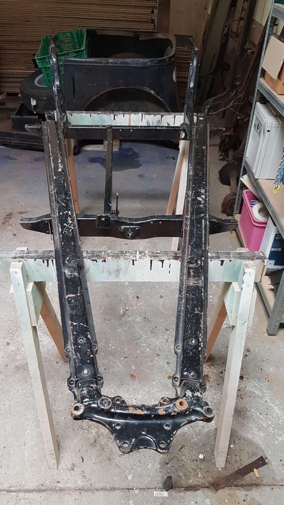

This chassis was after our research part of a Saloon.
Front axle is missing but we have a few in stock.
One thing we noticed is that on the front spring the leafs are straight cut at the ends. We also have springs that are arrowed at the tips. Is that a sign for the year or the model?
Rear springs seem to have lost some of their clamps.

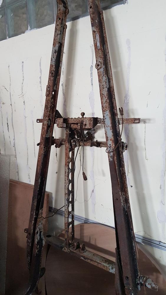

The next one had been worked on obviously. The rails at the rear seem to be cut off. Also is there a steel wire from"handbrake" going through the middle of the chassis. It apperas also to have the wired brake system due to the brackets that hold the small rollers at the rear traverse.

To start the ball rolling (no doubt you'll get help from others) the springs approrpiate to all your chassis should have squared-off ends, the tapered ones are from some earlier models.  All your chasses  with the V-dip in the front crossmember and the cranked-up extensions at rear are the Ruby-type which started in 1934.  I'm not at home to tell you the exact dates of the numbered plates, but sure someone will.   Presuming the diffs are original to the chassis they're on, you'll find the exact date of manufacture stamped into the top of the D-shaped diff housing - eg - 10/9/37 or similar. Good Luck with your project.   Cheers,  Bill in Oz

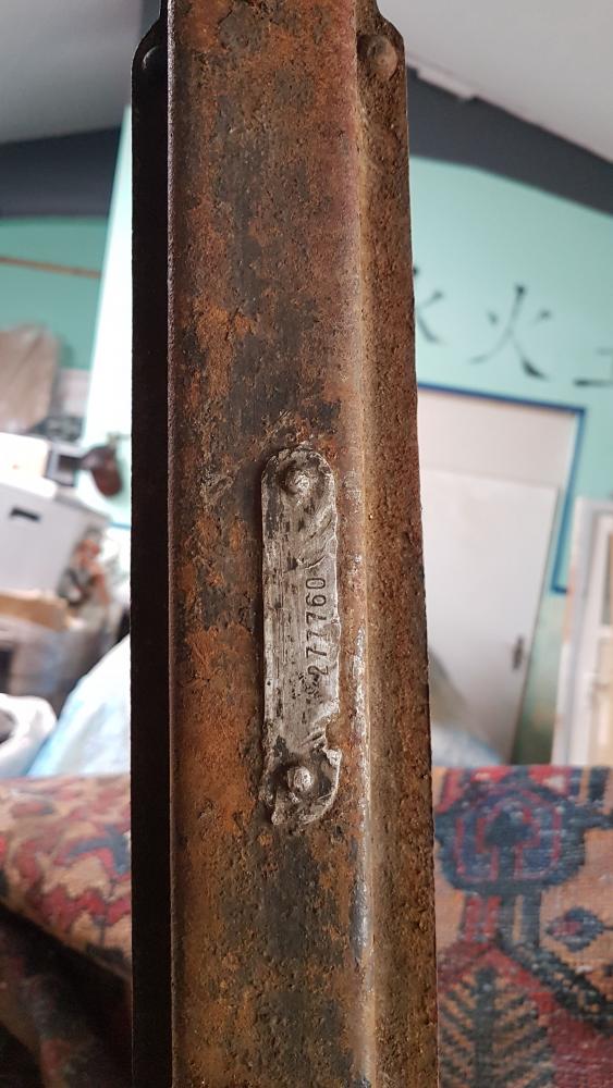

I posted this link a few days ago on another thread, it should help in identifying the build date of your D-shaped diff housings. I think some of the very early low frame Ruby type chassis still had the chassis number stamped into the rails, so may be worth checking out those that are missing the numbered alloy plates particularly any that don't have the two holes present to accept the riveted alloy plate.
http://a7ca.org/downloads/QuoteThisNumber.pdf
Is the first plate 233319 or 273319 ? - if 233319 it would be September 1935, if 273319 it would be approximately April 1937
277760 would be very late August / very early September 1937
