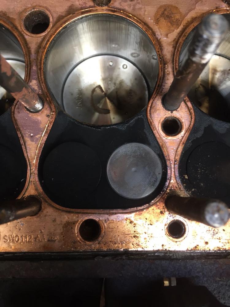

This engine was fitted and run for around 30 miles, although very quiet it had a tick and I really struggled to locate the cause of until I removed the cylinder head and saw this...
Removing the valve I expected to find it seized in the guide, it was not but this was clear...
I am not sure if the valve caused the crack or the crack seized the valve - it extended into the block so I made the decision to remove it (in situ) and machine up another block to fit - I did this over the space of an evening, finishing by torchlight...

Still slightly puzzled by your valve issue, looks like it was stuck open? That's an inlet I take it? (sorry, it's early in the morning). I think you made the right call in replacing the block.

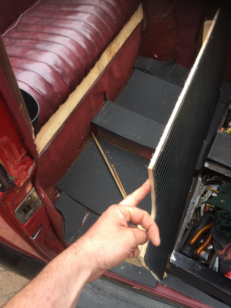

I removed the original rear side panels and made new with a slot for storage, mainly used for notepads, colouring books and knitting projects, the black plastic cups kept their pencils and iPods safe from the floor...
The final adaptation, in the rear, was to add a fake floor to allow for storage in the footwells.  I used this for parts and gifts we took...

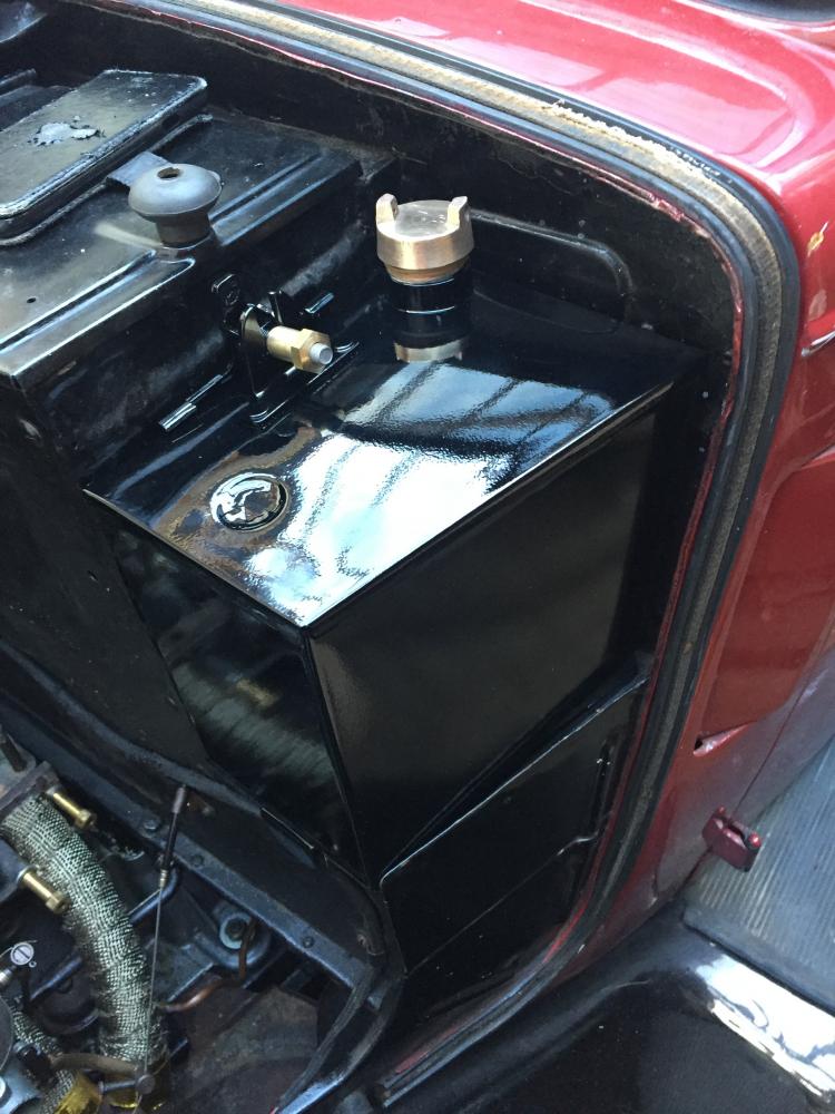

Under the bonnet I fitted the spare fuel can I commissioned from Andrew Goodfellow,

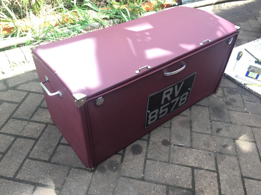

Peter Naulls made me a superb trunk that I covered and mounted on to the the rear of the car.  This had two internal compartments, one for our cool box and the other for our cooking equipment and dry food - this proved invaluable.

Valve was overheating (it is blue!) due to crack and then jamming open causing tappet to open up and tick.
Tow bar mounted to existing bumper using HT bolts back to chassis mounts - toured with the Nutshell Caravan on this set up, which is much heavier than the trailer, without issue.
Ah yes, that makes sense. Didn't spot the blueing.
