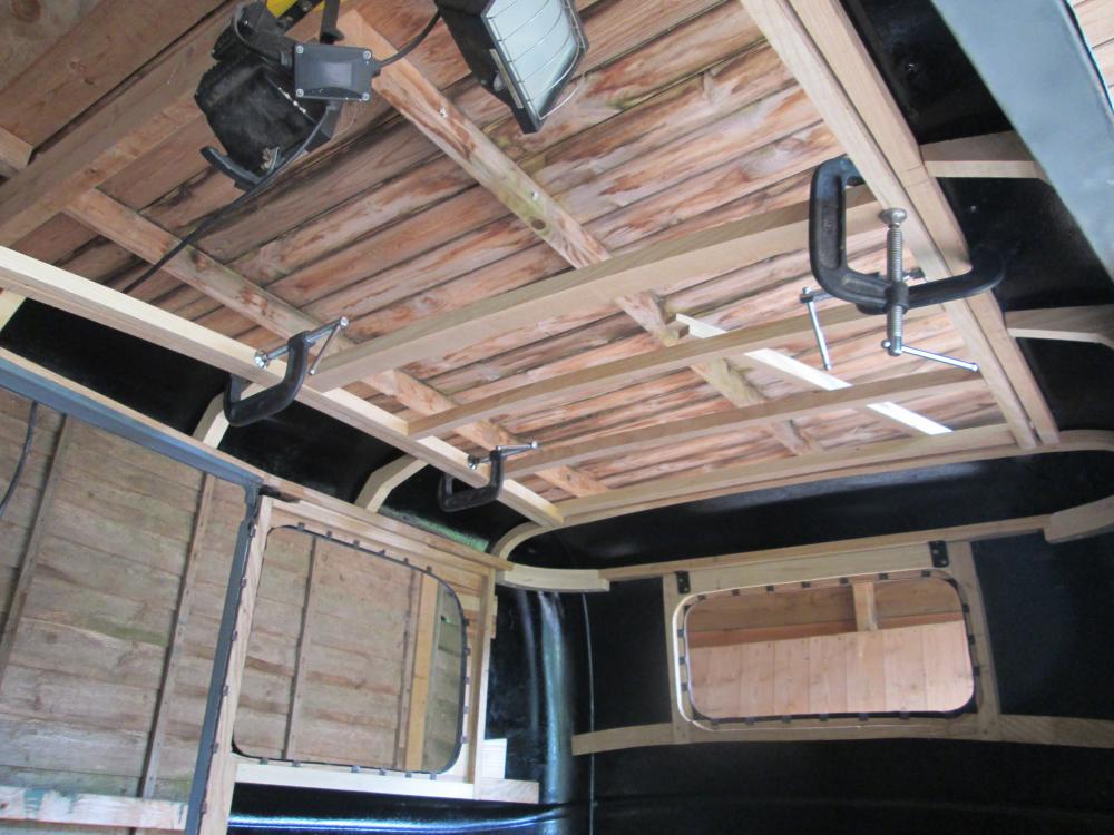

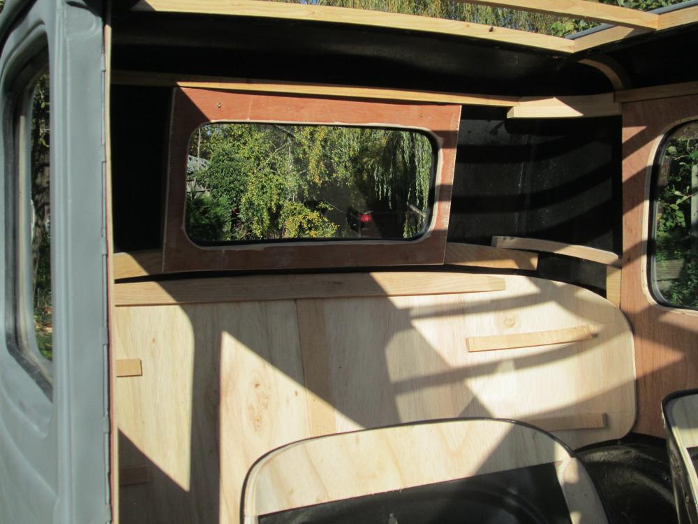

What a lovely car!  The body looks pretty good - far more sound than some that we've worked on.  Please bear us (Martin Prior and Son's Motor Works) in mind for any woodwork requirements.
Apologies for the commercial!

That woodwork looks good. I presume you make the plywood panels for the door cards, rear quarter panels, seat back etc?
My structural stuff has a bit of woodworm here and there but doesn't look too bad. All the ply sheets are totally shot. They pretty much disintegrate when you handle them.
