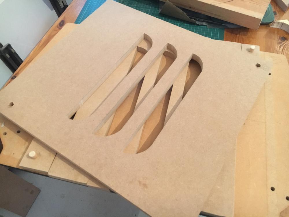

The car had some really quite large louvres in the nose cowl and bonnet, measuring 12" tall by 1 and 3/4" wide, ever since I started building the car reproduction of which have given me pause for thought. This weekend, I realised that the time had come to get on with it and have a go at making them:
Using my powered fret saw, having marked the outline, I firstly cut two jigs from 20mm thick MDF, a lower and upper, between which I planned to sandwich the aluminium panels.
I mounted the lower former onto another larger piece of MDF and ensured the two formers would align properly each time with a couple of dowels, which are positioned so they will not interfere with the panels when they are in the jig.

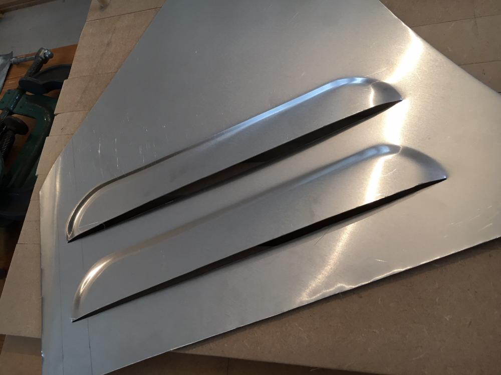

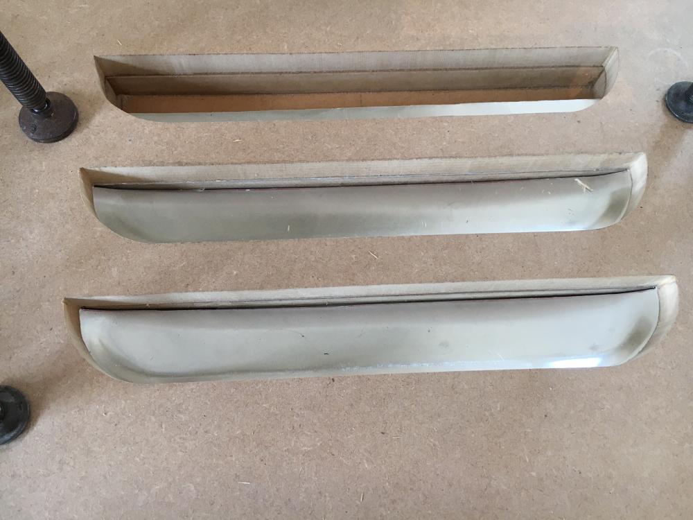

Having made the jig I was getting ready for the moment of truth; I firstly cut the slot into the panel for each louvre, these being for the cowling cheek, which unlike the bonnet, only has two louvres., I decided that given the size of the louvre I should anneal the area before attempting to stretch it in the jig. I then carefully positioned the panel and clamped the whole assembly together
Moment of truth! I placed the former into the fist slot, resting on the still pristine panel, then, using a rubber mallet, applied some persuasion
It all looked OK in the jig, so I unclamped it all and was pleased to find I had my first louvres. Initial worries that they would look wrong a different to the originals evaporated and I am pleased that they have just the look I was seeking.

Ian and Steve, I am interested to read that you both use similar methods. I have to admit I was actually unsure that I wanted consistency with these louvres, the period photographs show just how 'inconsistent' the car was in detail. If you look at the following picture of the original panel on the car, the rear louvre opening is narrow, the front one wide!
.jpg   IMG_1777.JPG (Size: 56.98 KB / Downloads: 250)
so I was more than pleased to discover that the louvres I have made for both sides of the car, have the same pronounced variation between the front and rear. It must be just the way the metal reacts to the size and shape of panel, slot and louvre.
