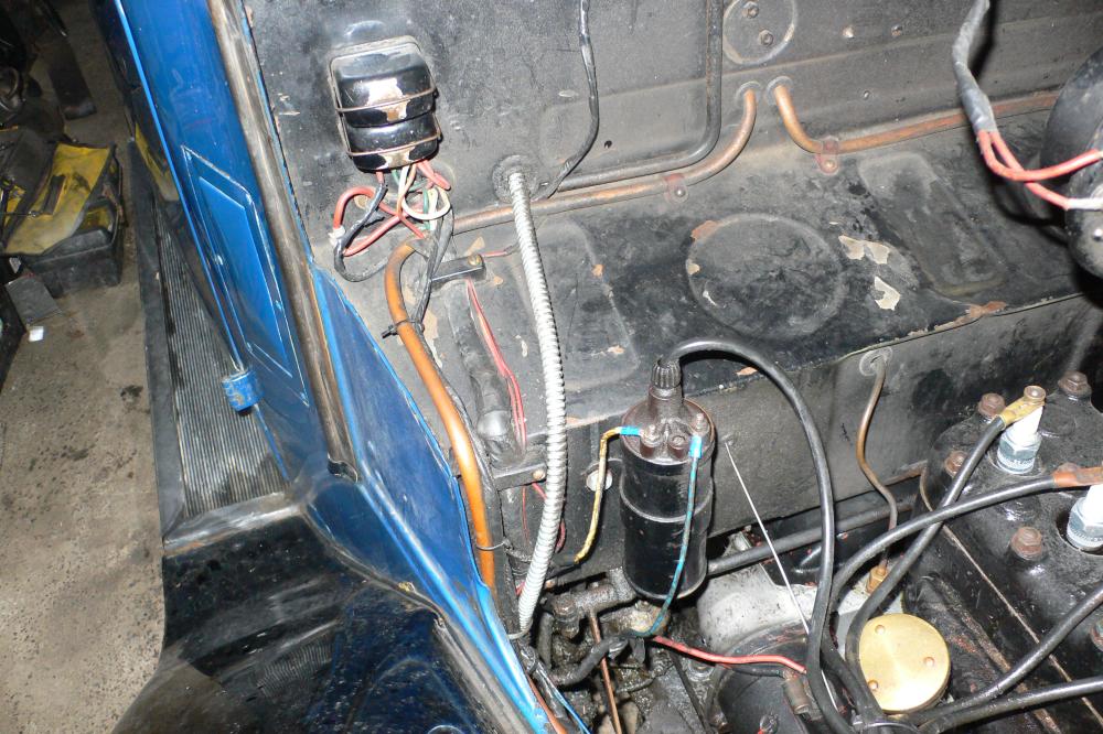

The second picture shows the location of the cable from the bulkhead grommet leading to the back of the dashboard. It passes to the right hand side of the coil down to the offside of the radius arm:
[Image: 20211101-132556.jpg]
The cable is free and not secured other than by the gearbox connection and the bulkhead grommet. It has been like that for 40 years.

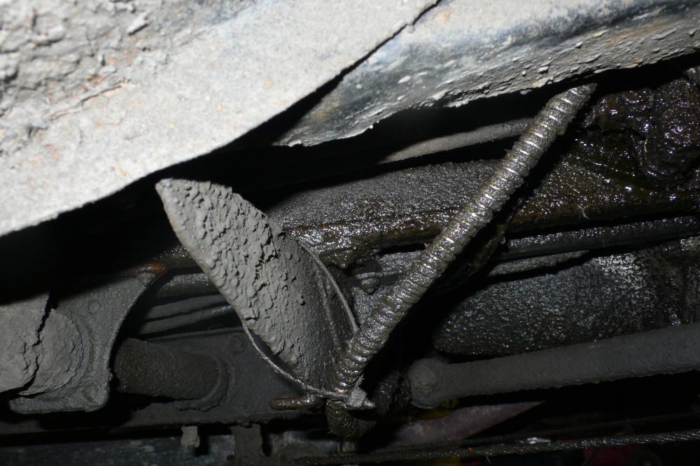

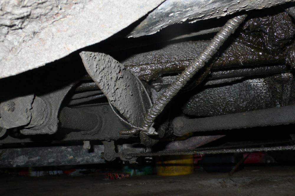

My speedo cable route is similar to Bruce's:-
Like Bruce's car, the only support the cable has is its connection to the gearbox and the grommet through the bulkhead. the only modification is that I have cable-tied the outer cable to the front crossmember to stop it getting mixed up with. the steering drop arm and draglink.
