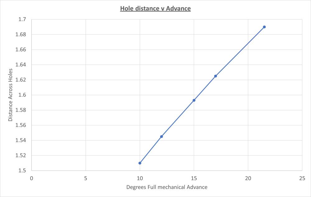

I know that but what size should the hole be if I want to convert a 10 degree plate to 14 degrees. That’s the information that I’m lacking (or a vast selection of distributors to note the degree markings and measure the holes!)
Thanks
Charles

FWIW I have a note that a DK4A (8 deg) unit had holes 8.5mm in diameter, and a DKYH4A (17 deg) had holes 10.5mm in dia.
In both cases the pin was 4.75mm dia.
i.e. 3.75 vs 5.75mm travel.

I have a 21 degree plate (but haven’t measured the hole yet) so may be able to interpolate the figures if the relationship proves to be linear.

I measured the amount of advance available by twisting the distributor rotor with a protractor sitting on top of it. I then filed the holes in the plate to be oval and remeasured the advance angle. With consecutive filings followed by remeasuring the angle, I eventually obtained the amount of advance that I wanted.
Bear in mind that one degree of advance at the distributor rotor is two degrees at the crankshaft.

I did the same as Graham. The holes and the pins were both slightly worn, so having first welded up the holes I filed them out bit by bit until the correct advance had been reached. I was surprised how much difference it made to the running of the car.
