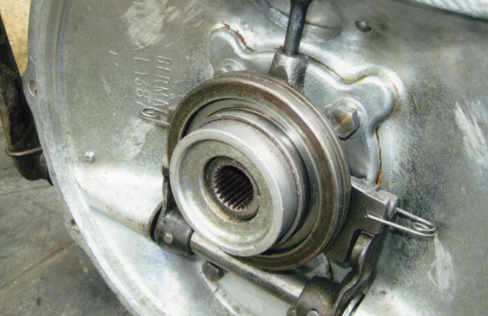

The best way to repair a 3spd clutch bearing is to replace it with a 4spd bearing which does'nt rotate all the time the engine is running.(see attachment) ignore any reference to Renault this is a race conversion that uses the same setup.
