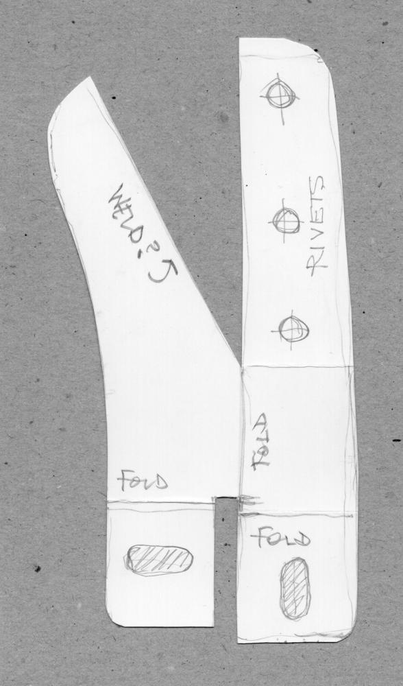

Does anyone have any detail pics and measurements of the front body supports that connect the bulkhead to the front cross-member?
They appear to have been pressed/folded from 16 swg steel, approximately 5 1/2 inches high?

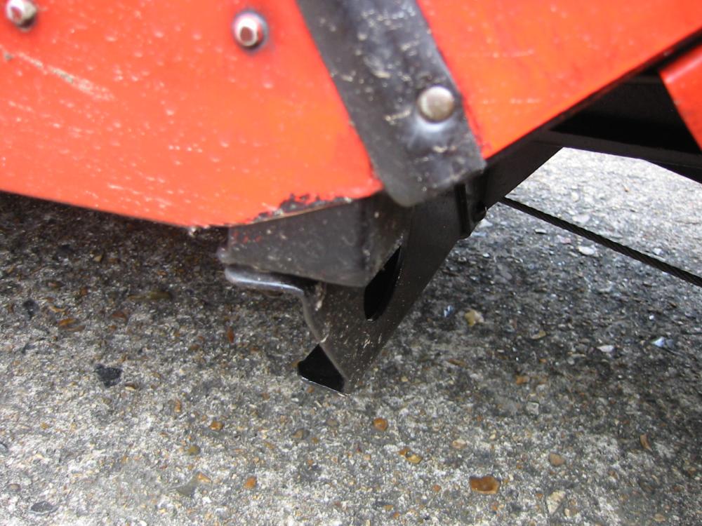

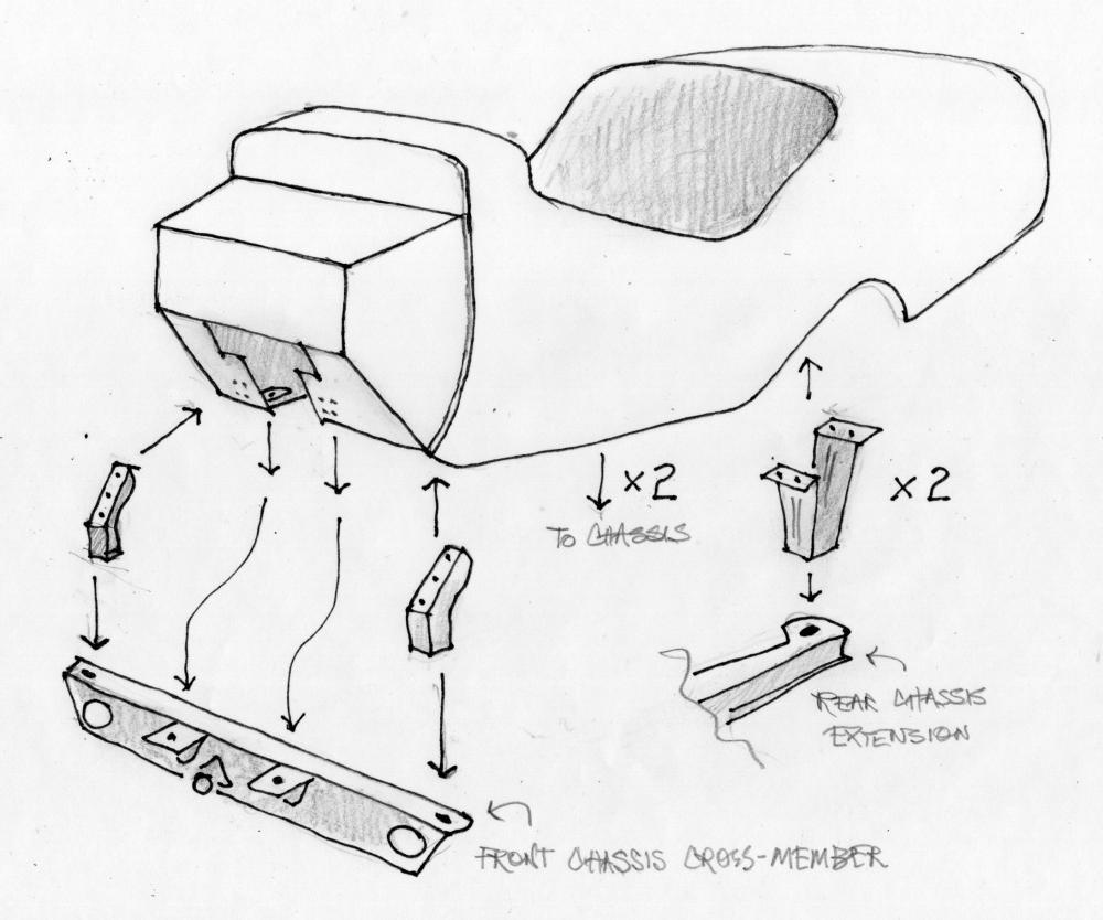

Erich, there are indeed 4 body supports. 2 as per my original post. These are riveted to the bottom of the joining flanges of the bulkhead and the front of the aluminium body skin.
    (This is a TT but the bottom of the bracket is exposed)
The rear pair are riveted to the sloping rear floor and fit to the end of the chassis extensions.

The brackets you mention are standard Austin. cars made with 3 speed boxes have the brackets pointing forwards. Cars made with 4 speed boxes they point backwards.
Great to have that drawing Henry. I imagine those brackets are the sort of thing that Oxfordshire Sevens (other companies are available...) would easily pop out in addition to all the forgotten Nippy ones they have been researching. I'd be interested to know if all the real EA bodies' vertical face of the bulkhead looks down through the rear engine mount holes, as per the drawings. And whether the forward facing inner front cross member supports are partially showing (at the front) when bolted down.

I have asked Atho to contact you Henry he has dimensioned patterns from a genuine car that he can supply you with.
From our studies the replica bodies including CC which were once lauded as authentic all have a number of inaccuracies in their construction. Atho has catalogued everything that we are currently aware of and there may be more.
