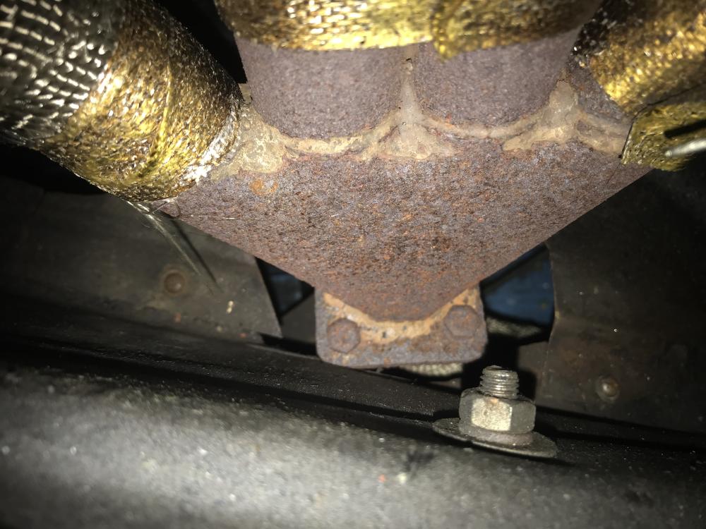

The only problem to fitting this in a Ruby might be the Dante Manifold downpipe.
not at all.
it came out of a ruby chassis special. its only the exaust pipe that needed shortening.

(17-02-2022, 08:04 PM)dickie65 Wrote: Hi,
I have a similar exhaust manifold on the Pearl, as Tony says, you simply shorten the down pipe.
This engine in stock Ruby would be superb, do it!

Hi Tony,
I was not sure if the inner flitch panel would be a problem on a Ruby which was why I commented.
