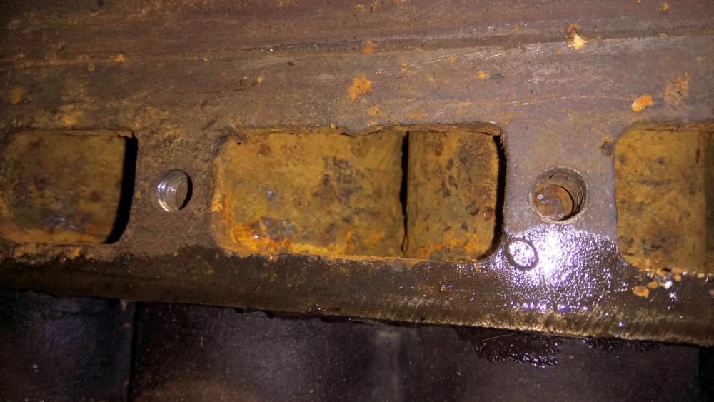

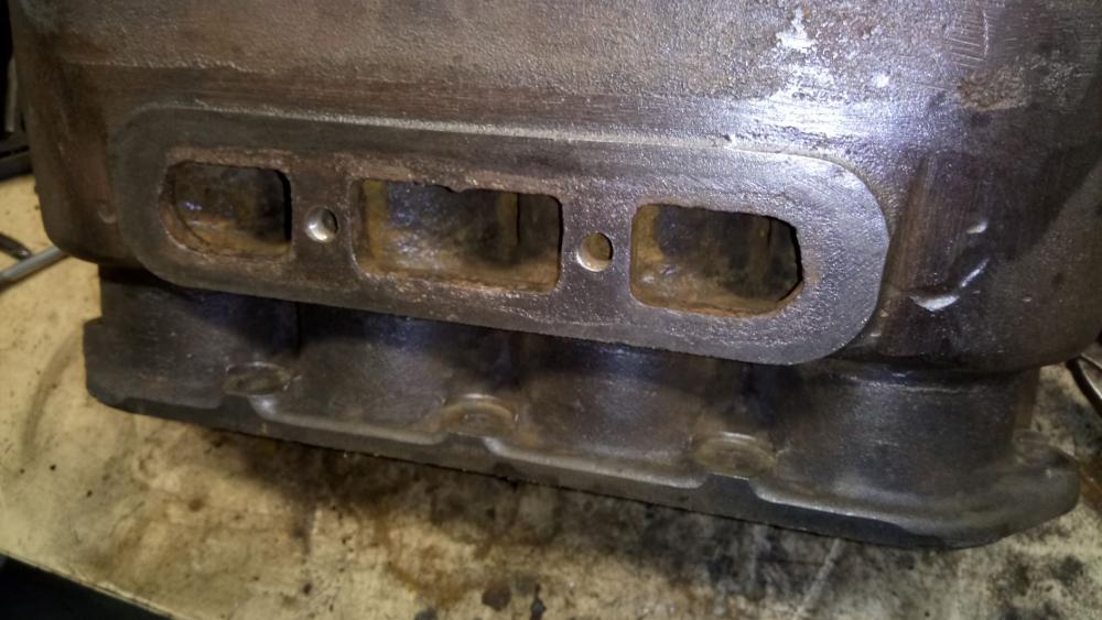

Here are before and after pics from the Top Hat engine electrolytic de-rusting:
Block before:
And after:
This bucket of sick is actually the electrolysis bath working:
The head came out like this (no before I'm afraid):
out of interest, did you find that you got "pores" on the dressed face underneath the head, or did you reface anyway?

Hi Jon, no the uncorroded metal comes out of the bath just as it went in!
