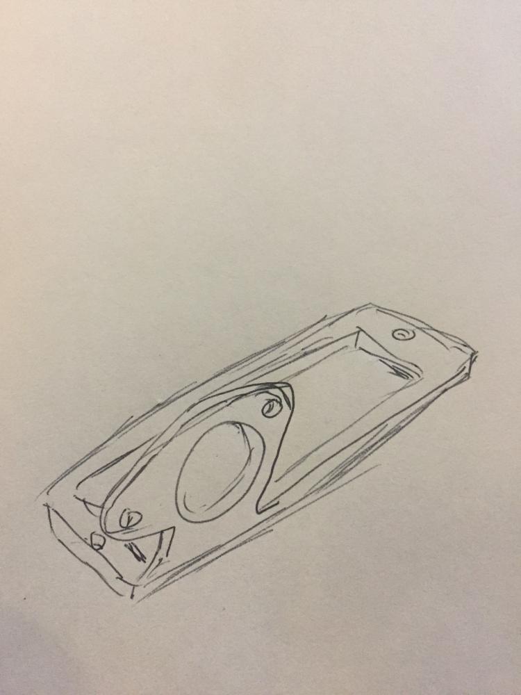

I cannot locate it just now but somewhere in the sheds is a homemade brace for this type of starter (see sketch below) - I wonder if making similar with a tin cover might allow you to be more creative with the shape and get what you need?
