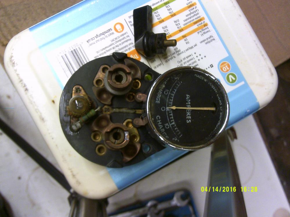

        Here's a couple of photos, which may help. In the front view you can see a modern resistor I have fitted to replace the defective original wound round the bulb holder.
Thanks Dave....well,sort of! That looks as if I will have to take all the wires off and dismantle (again) my rather fragile panel. I will initially try & put a connection to D+ as suggested by John C. This may not be as easy as I think with my limited soldering skills! I do at least have a good solid earth wire at the cut out from the E terminal!
