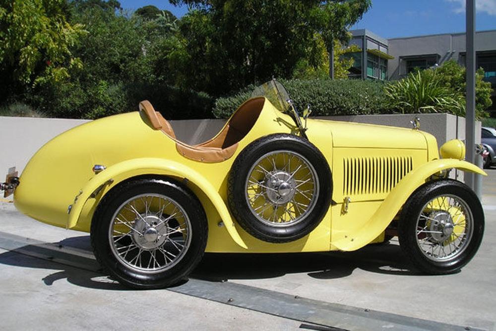

Bella, I believe this car was built using fibreglass body sections for example the tail and scuttle at least, these are I believe copies from an Australian Meteor body that I am informed are are still available through the club there. The doors are I believe something added at the builders whim and the wings may well be modified steel austin. I know you have said not, but I suggest you look at the car more closely and this information may help your cause, you could conceivably argue that this is a Meteor replica, certainly that argument has more credibility than it being a Speedy replica. It may even be the case that the car was constructed in Australia before being imported to NZ, sadly form the moment the car appeared for sale here there have been attempts to deceive potential purchasers.
#43
@Ian Williams
Thank you for the hints.
I'm not a native speaker. What is a scuttle? My translator says it is a little ship. It is the bulge for the accelerator pedal?
The car has two dents at the tail. That is impossible if fibreglass is present. The wings  are made of aluminum too. You can see the weld. I agree that the pre owner does not loves the truth. That is a reason I'm in difficulties. Facts have been obscured to give the impression that it is a sports car - say Nippy, Ulster, Speedy or Grasshopper. In the DLVA registration certificate that efforts perhaps end with an entry as "sports".
Do you have a picture of or a link to that meteor body? When did they start with that body?
If you say an owner has made attempts to deceive potential purchasers -  can you determine a timestamp? One thing I found is that the car has been in the hands of NZ Cartel Works. See Scroll down to pictures.

The Austin Seven Club in Melbourne has been manufacturing fibreglass Meteor replica bodies for over 20 years.
Fibreglass Replica Austin Seven Meteor
.jpg   Fibreglass Meteor2.jpg (Size: 68.69 KB / Downloads: 268)
Austin Seven Meteor body- possibly fibreglass- side view.
The original 1930 steel Meteor bodies were regularly built by Flood Motor Bodies Melbourne.

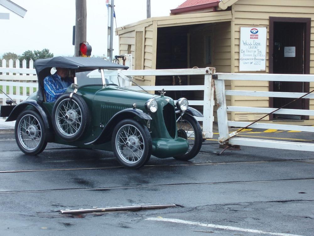

#50
This is a n Austin Seven Speedy- with lowered chassis using flattened springs and dropped beam front axle.
