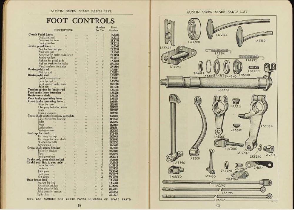

Hi all, i'm up to my neck in a brake redesign on Patrick's Ulster project. The system will be mainly hydraulic, but i'm considering using the rod operated girling actuators i have, for the handbrake. I have a wiffle tree, rods, actuators from a late Ruby axle. What i'd like to see is a picture of the cross shaft end of this mechanism. There must be an upwards pointing lever on the cross shaft, to one side of the propshaft? Do any of you good folk have access to this area of the gubbins for a general arrangement photo? The cross shaft assembly in the chassis (at the moment) is an early ish coupled system, it is a late 1930 chassis. W

Thanks chaps, still want the picture though. I'm not using the conventional MM brake conversion, but scratch making some wheel cylinders that install in place of the Girling adjusters. I've driven a push on handbrake equipped car and do no feel that in a car by & for a youngster, for racing, hillclimbing, trials etc. that it is a good idea. Over the years i have driven A7s with wholly inadequate brakes, barely adequate brakes and excellent brakes, The latter is the only one worth achieving! It has been a lot of work so far, and there is much more to do, and may ultimately be a blind alley.......Only time will tell. One of the design criteria is to end up with a good rear acting handbrake, for handbrake turns obvs.... W

OOh now we're getting somewhere! So how long is 1A 5565? W

Ruairidh's photo of an installation on a special shows the for and aft rod passing thru a block on the rear crossmember and relying on flex in the rod for up and down travel of the axle.
In the factory arrangement there is a slave arm pointing upward in this location linking 2 halves of the same rod. Possibly not required on a special with limited axle movement.
