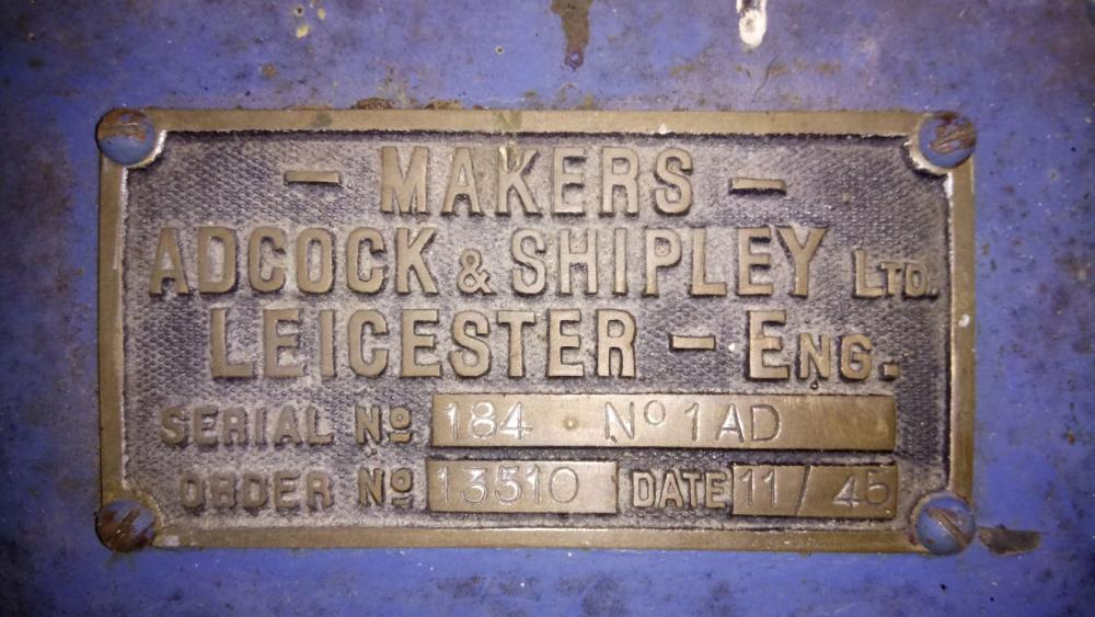

It’s an Adcock & Shipley 1AD, manual toolroom mill, with vertical and horizontal capability, manufactured in 1945. Unfortunately, because of its age, it has obsolete taper fittings, 1 3/8” non-stick, which was a wartime UK standard, subsequently replaced with metric international standard tapers. I didn’t realize this until after I had bought it and tooling is very scarce apparently; I’ve never come across anything in the last twenty years that will fit. Caveat emptor! However, I have the horizontal arbour and I have turned up an adapter that will allow 30INT taper tooling to be used in the vertical head, probably with reduced accuracy. There is also the possibility of a Japanese CNC taper that may fit (BT35).  I have acquired quite a lot of horizontal cutters and a selection of end mills over the years so I now have a reasonable amount of tooling. I will need to add a dividing head at some stage.

Interestingly, there’s a video on YouTube of a working A&S 1AD, it’s only 2 serial numbers different to mine and was produced for the same order!

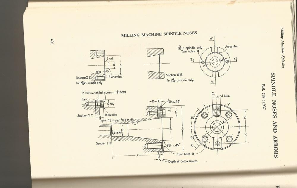

I think this is the BS spec that your machine was built to

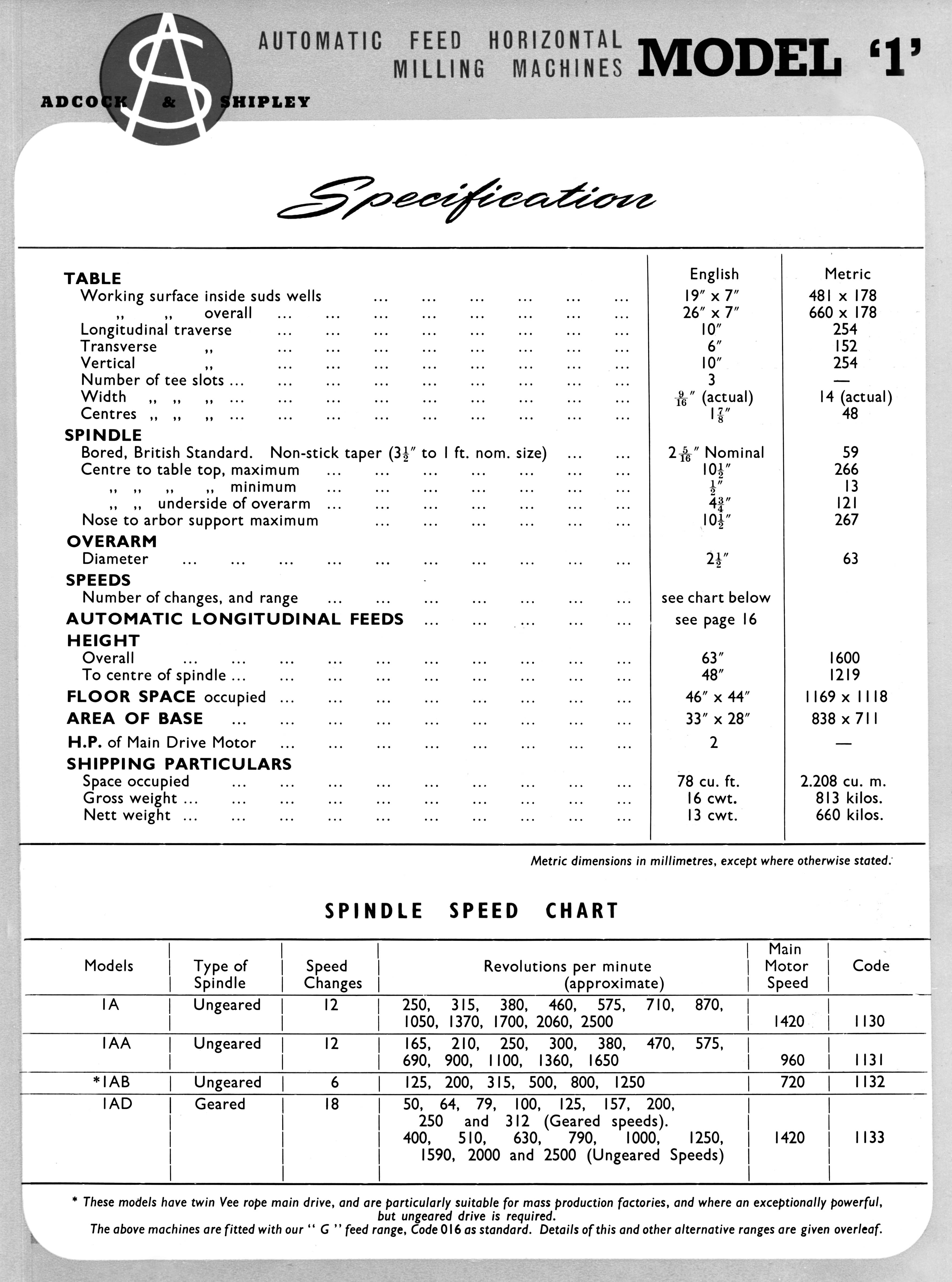

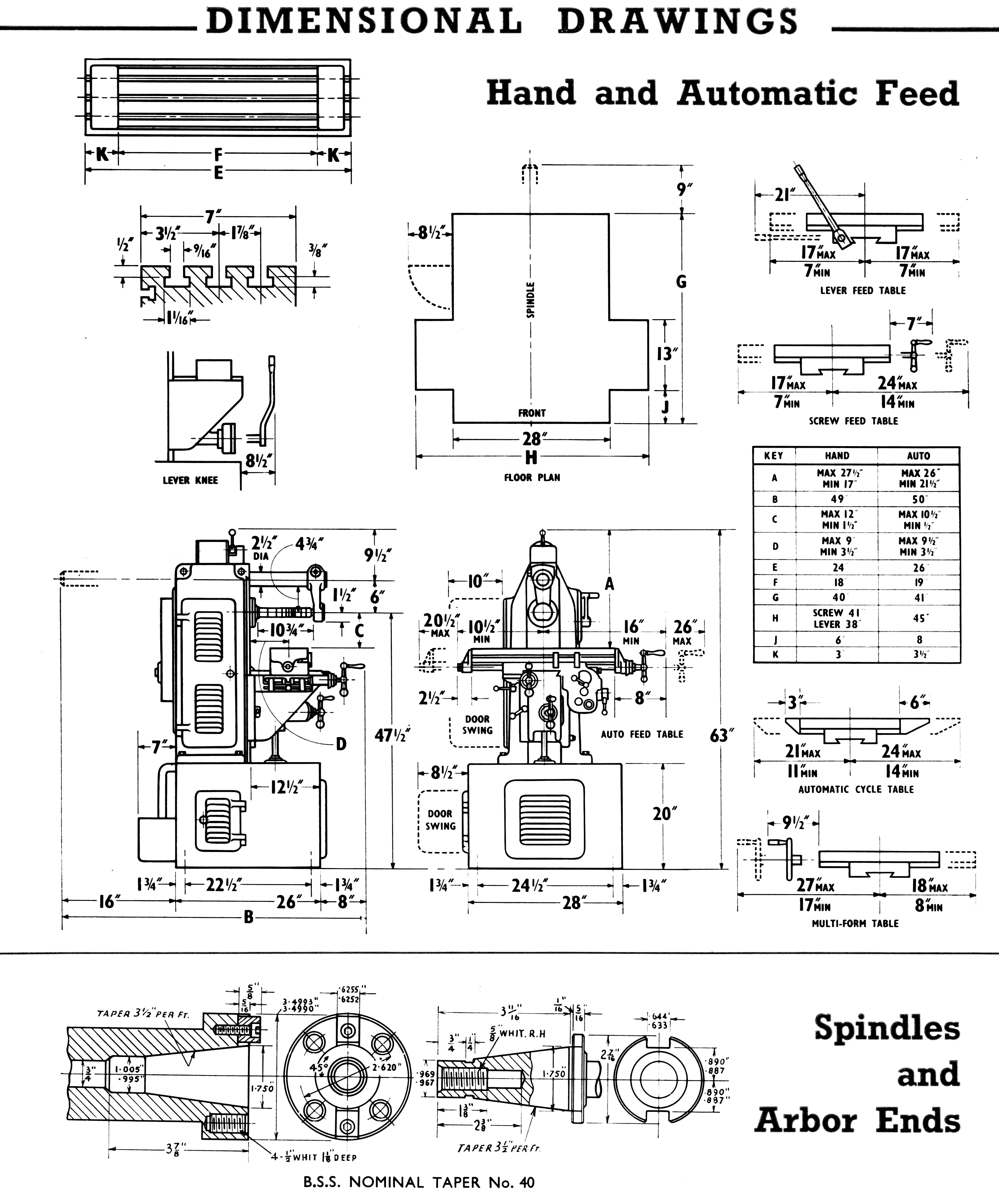

Here is a little more data for you. The last picture is of a No.0 miller, A & S used a similar series of pictures at the time. The girl running the miller might be 18-year old Mavis Ramsbottom, a trainee from Accounts - far prettier than the girls on the shop floor, or perhaps she and the photographer had something going?
[Image: asno1.jpg]
[Image: asno2.jpg]
[Image: asno3.jpg]
[Image: asno4.jpg]
Thanks for all the info guys, it seems my mystery taper is 2 5/16" British Standard. I reckon BT35 will be a close match as well, we'll have to try it to see!
