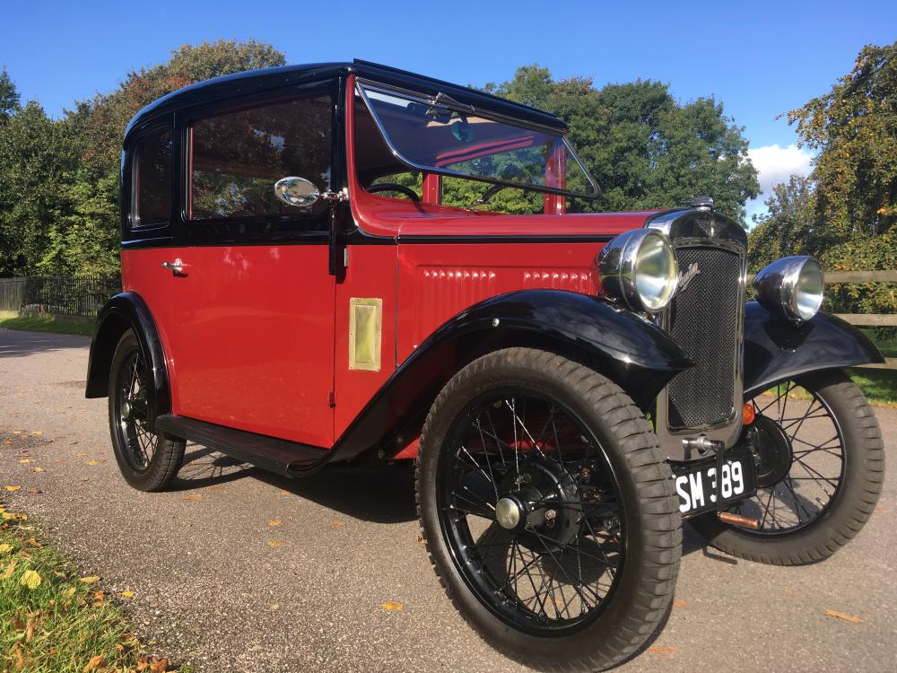

I would recommend "The Austin Seven Manual" by Doug Woodrow. as well as the sage advice of the forum members. By the way, nice RP, but your starting handle should sit horizontally to the offside not vertically. It may be due to wear in the nosepiece, but you can sort it by a bungee strap fastened to one of the cow horns.
Andrew, Welcome to Sevening! I agree with everything that Reckless Rat has said. I should add that, if the starting handle is not at 9 o'clock when running, (a) it will jingle and (b) oil will run out of the nosepiece when the car is parked downhill. My RP does exactly this.

Looks to be an exceptionally good example - and so well worth keeping on the top of.
Thank you all for the replies, that was going to be my next question how I get the starting handle to stay at 9 o'clock.
The car was fully restored in 2015 and never hardly used .

Recycling a redundant dog collar.

Good evening. What an attractive motor car. However is the nearside headlamp the correct LB130 or an L131 as fitted to Mk2 Rubies?
