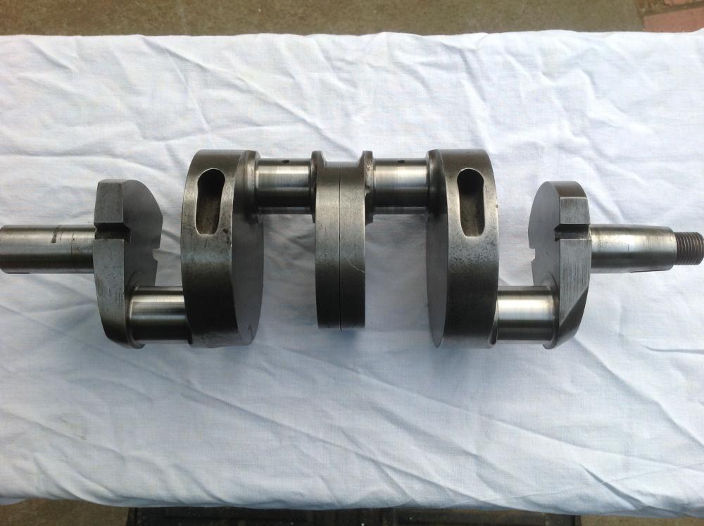

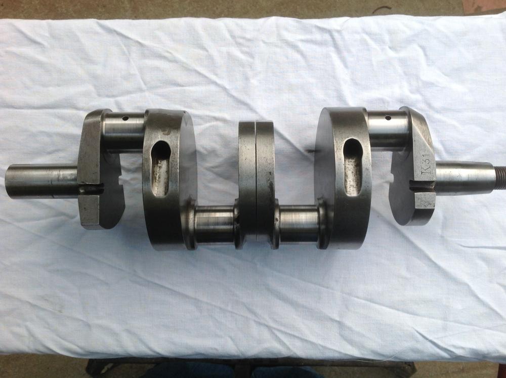

i keep looking at gene`s crank, and cant work out why its made in two parts???
i need more beer.
tony
#27
It is too big to go in either end, Tony I think you've had too much beer!
#28
I always presumed Laystall cranks were made in two parts so that they could be installed.
#29
I need more beer too, but it’s like the wizard says. I believe they have a reputation for reverting to two pieces, not sure how justified this is. It doesn’t seem that difficult to me.
Alan Fairless
#30
Fear enough.
But why not do the same as they done on the original counterballanced engines. And open up the hole in the rear end.
It's a bit like taking a part of a lathe, when you put it back on. It's never 100% in the same place.
Surely a two piece crank would be the same?
Tony.
