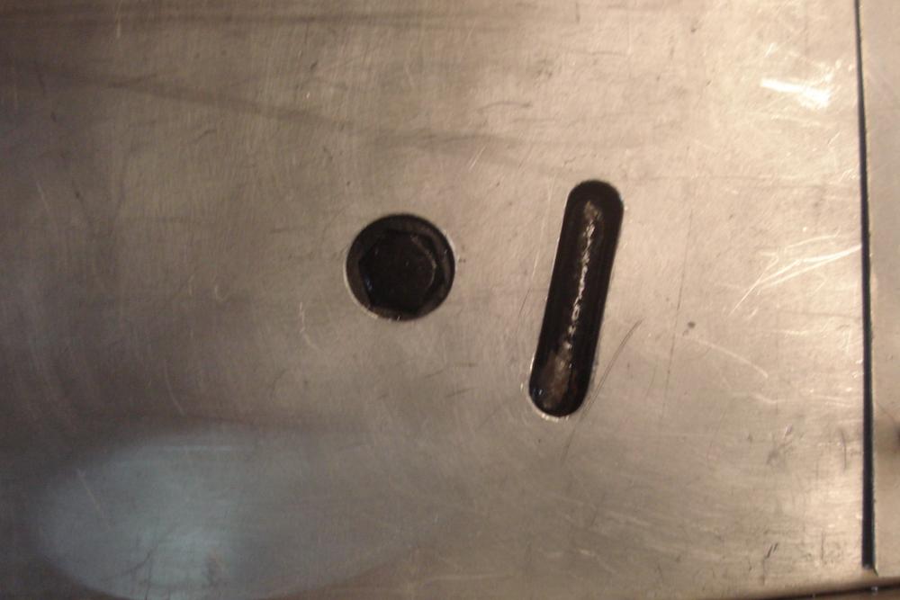

So far, so good. All the nuts are easily unscrewed and removed but not the powerful bolt. I'm going to have to make holes in the floor to withdraw them. Lunch and then a run to a friend's Steam and any other interesting vehicles gathering fo a couple of hours. Then back to fight with the pins.

I consider it sensible to do this to the floor when building a special to allow later spring removal.
#26
I realised that was the case the minute I looked at the spring mountings! If only...
#27
I made the same mistake on the first special I built Duncan, never again!

I've taken out one spring this afternoon and found it to be completely flat, no curve at all.
I'm a little concerned that I found a "spacer" which is much narrower than the spring, sitting on top of it. Should this be there? If so, why is it much narrower than the spring? It's the piece of strip with one hole(for the powerful bolt) sitting at an angle to the spring in the pic.
 Any advice is most welcome.
#30
Depending on how deep the slot in the chassis is, the spacer may have been to keep the u bolt tight to the top of the spring. I had a fat spacer underneath the tourer spring (6 leaves not 7) made of hard fibrous board...
