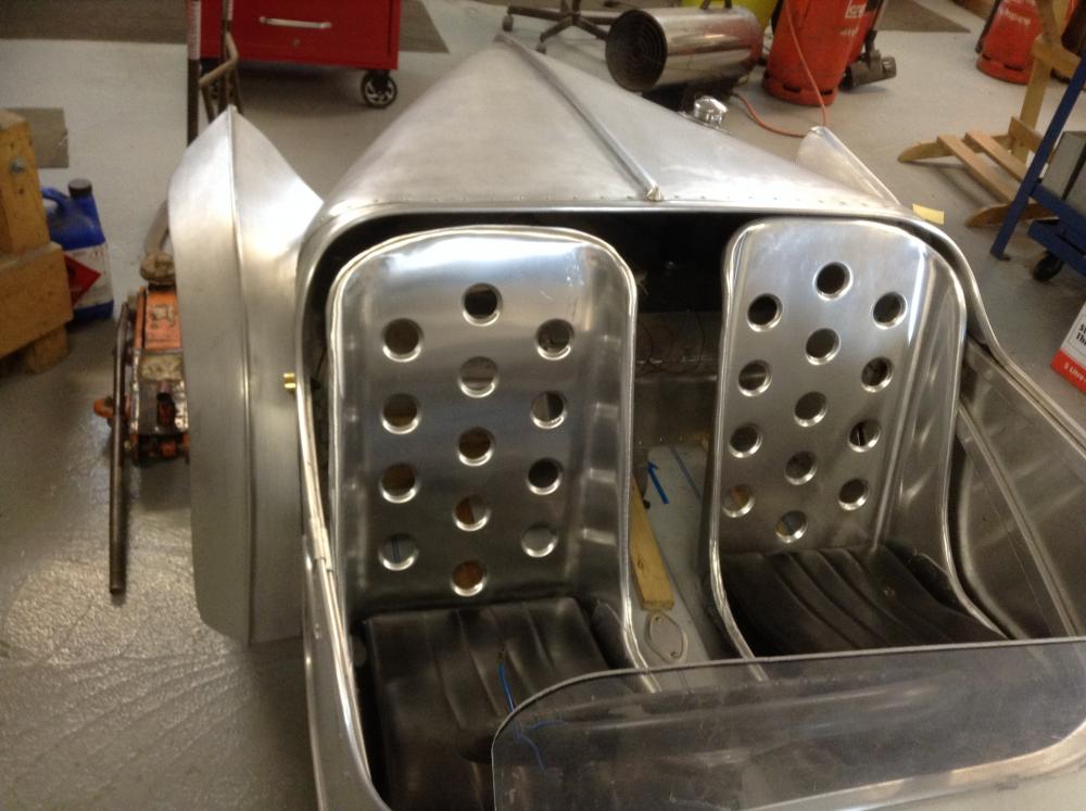

Since my special is most likely only ever going to be used by one person I wanted a good drivers seat so I used a Ruby seat than I cut about an inch and a half from the middle and welded back together. It was too wide otherwise. I did the same to the base so it retains the sliding function although I bolted the base frame onto the floor directly so no tipping. The passenger side will have a simple rectangular seat base and padding on the rear firewall. I'll get the trimming done by a professional upholsterer.
