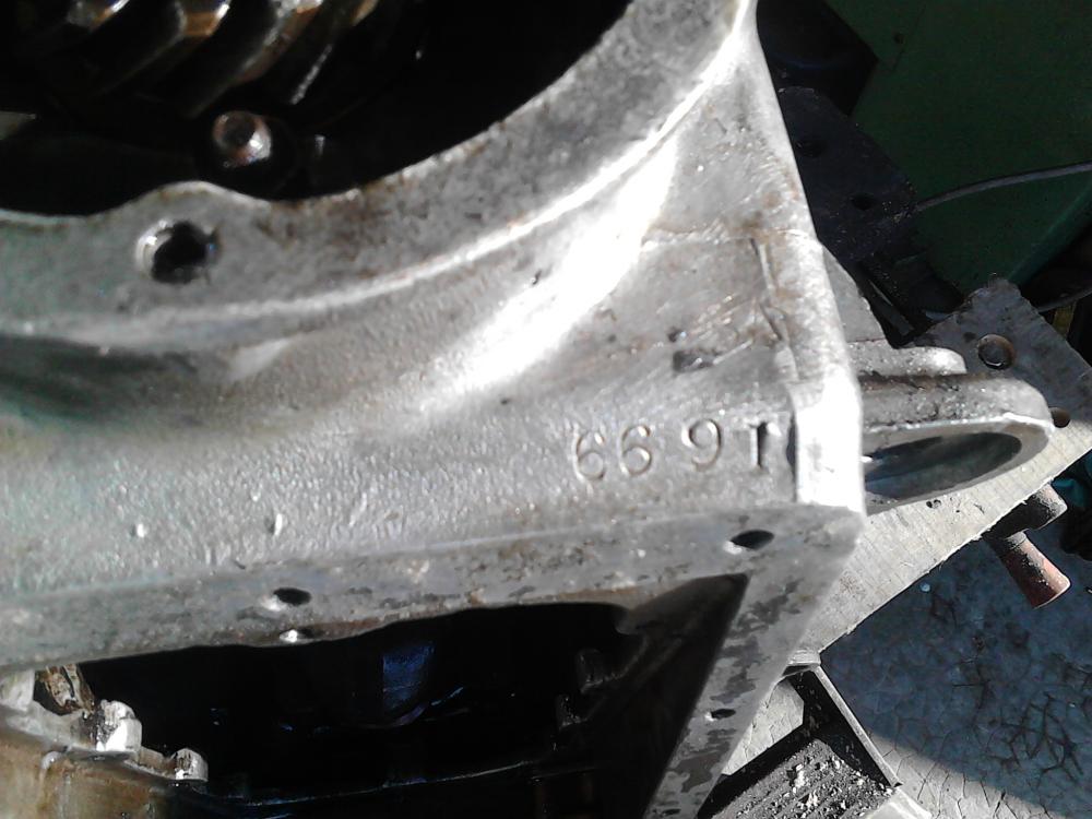

Thank you to everyone who has given helpful advice so far. It's very much appreciated. The crankcase number is 6691 stamped just above the sump.
That is a mighty early number. Sure a digit or two not missing? Anyway seems the longest housing so combination errors possible
If an early engine all bets are off - stop and take advice.
A number stamped on the front, above the sump probably isn't an engine number

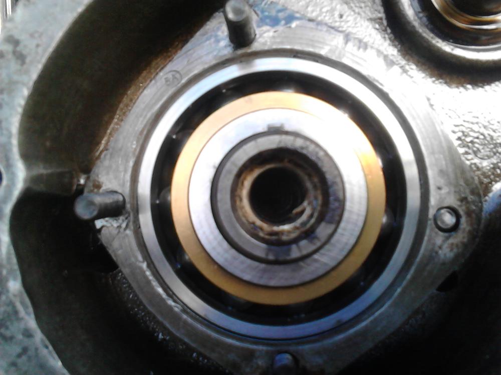

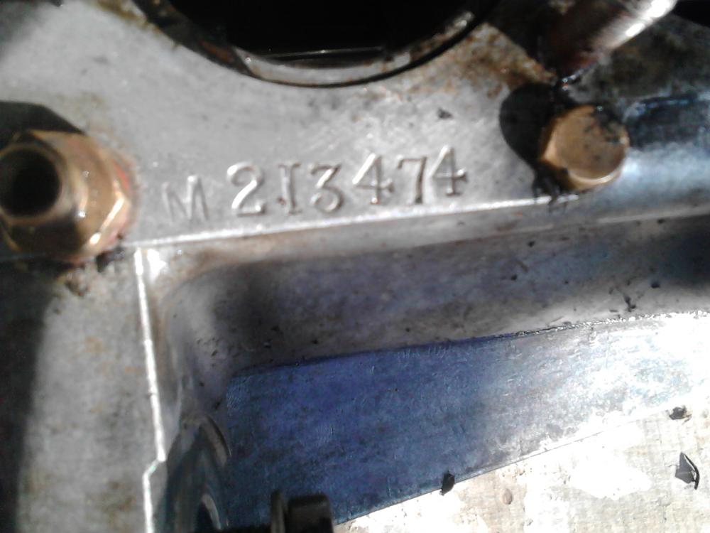

It's not an early crankcase. Sorry I gave you the wrong number. I'll take of the small front timing gear in a minute and the front bearing outer retaining plate. If the outer bearings have been spinning in the case it might have worn the case, which would explain the rumbling noise. I hope it isn't. If it is, hopefully if I clean it thoroughly I can loctite the bearings in place or a slight film of JB Weld, then fit the spacer rings to take up the end float. I'll post on here soon, when I've removed the small gear etc.

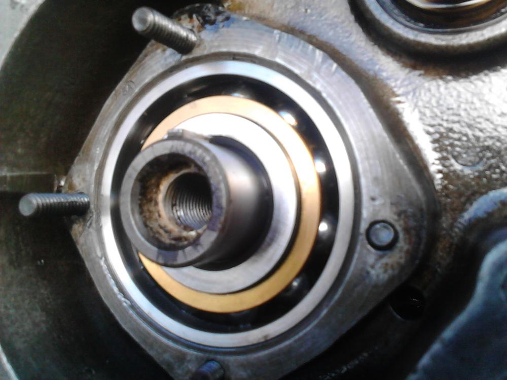

Got the end plate off. Bearing outer is clearly loose in the crankcase. Can't feel any up and down play, so hopefully loctiting the bearings & fit a spacer will sort it out. There is no "Thrust " wording visible and it looks like the bearing is fitted the right way ( the outer one at least ). Now I have to see if I have any of the shims / spacers to take up the end float. It's unlikely I have anything that size. Are they available ?
