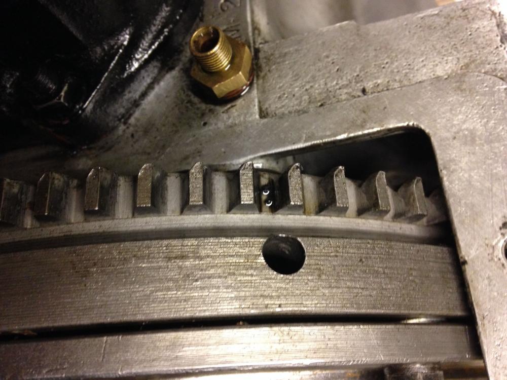

In case it is relevant, this picture shows the slight but noticeable chewed up teeth, a bit surprising on quite a new ring.
Are the ring gear teeth damaged all the way around ?
Yes the ring teeth are damaged all the way round, giving an early suspicion about a possible cause of the noise. However first using paper and then thin card between the ring and the housing it was evident that there was still clearance between them.
(25-11-2018, 09:12 AM)Steve kay Wrote: Yes the ring teeth are damaged all the way round, giving an early suspicion about a possible cause of the noise. However first using paper and then thin card between the ring and the housing it was evident that there was still clearance between them.
Were these ring gear teeth marks there when it was first fitted ?
As far as I know the only reason the ring gear teeth can get damaged is during starter motor engagement - which is usually only at high compression points - not evenly spaceed all the way around on all teeth- besides aren't they damaged on the wrong side of the teeth for starter motor engagement wear.
The ring gear is not clipping the rear sump bolt is it - with a bit of end float in the shaft moving it clear when the motor is tipped over ?
Seems unlikely but worth checking.
Probably not relevant to the noise, but the clutch cover/pressure plate has a gap between it and the flywheel, is it spaced off, or are the 6 bolts not fully tightened.
Have you taken the starter motor off and then with a stiff piece of wire shaped at a right angle scraped out behind the flywheel just in case there is a foreign body there. Also whilst the starter is off start your engine on the handle and see if the noise is still there.

What a wonderful team you are! I was wondering whether to put on freshly ironed shirt and tie and go to the chapel for hymn singing, or go to the pub to listen to detailed descriptions of a certain sporting victory in Cardiff yesterday. Then I glanced at the forum, and scarcely pausing to put on overalls rushed to the workshop and loosed off the two sump bolts imediately below the flywheel. Silence, not a sound. So the marginal protrusion of those two bolts and a very  slight eccentricity of the toothed ring meant that little interference. Many thanks to all, and especially Tony Press for such valuable help.
