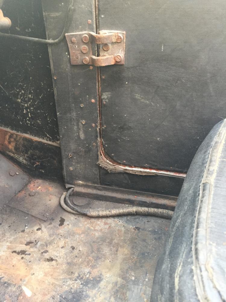

I am fairly sure this is unadulterated and should be a good reference...
A spare ARR Ruby door I have here has the remaining original interior around the window attached with pins - no screws or cups.

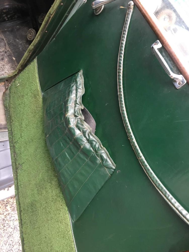

I removed a set of what appeared to be original door cards from an mark 1 Ruby last week. They were held on by some sort of brads, with the odd nail where there framework had deteriorated to the point that a brad could not hold.
Jamie.
