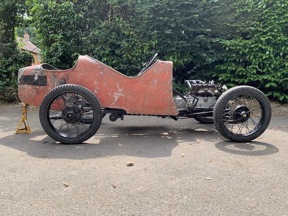

Quick update on MV.
For some rather boring reasons there hasn't been as much progress as we wanted.
A lot of time has been spent sorting out the bodywork, the crashed TT tail has been (very) carefully unfolded and is looking good.
Below is the first test fitting, (bits were in different locations before this). Steering column is to short at the moment, this is a known issue for us to deal with, the standard one on it was done so we could take it to the centenary event.
Lots of drawings and bucks are being finalised for the bulkhead, floor and tank, all done from references of various existing cars.
Finally the decision has been made to sell the special body it came with, it's not something we are going to put back on at any time and could be of interest to others and will save space in the garage.
Link on eBay here

(11-07-2024, 09:30 PM)austin Wrote: Quick update on MV.
Link on eBay here
Looking good Austin.
I know this was debated when you acquired the car but I really think the TT body on this chassis is a good solution for both.
And I had to lengthen a steering column for my car. It’s very possible if you plan the joint design and welding thoughtfully.
Charles
PS. I see that “750R” has now gone from the tail. That must have been on there for considerably more that half the body’s life!

Using this body, on this chassis, is absolutely the correct thing to do. A very in-period action, t’s going to be superb.

The 750R is still there but has faded a bit due to the heat being applied to anneal the aluminium.
It looked like this to start with:
[Image: 1359054615_dcaa776930_c.jpg]
HH TT 2
by henryharris, on Flickr
The "folded over" bit took a lot of time to work out, various bucks, hydraulic tools and a lot of looking and tea drinking were involved. Have to say pretty happy with the result. It's not perfectly smooth but I never really wanted that anyway.
I was wondering about the ability of welding to extend the steering tube but felt nervous about it for obvious reasons. The other Ulster has a standard one with a Blumels and you soon learn to not let your fingers get to 12 o'clock!
