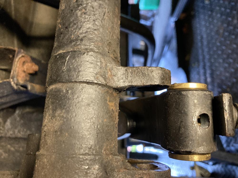

This time the car is supported on the rear frame by an axle-stand. The axle is supported on an axle stand and I have compressed the new spring jacking it into plave with the A7 jack again. Result is as the attached photo - not a long way off but.........
Is my mistake in having tightened the u-bolt first? Although I don't think that would give me 1/8" to 3/16" of wiggle room. Just when I thought I could see the finishing straight. Chicken and hatcheries come to mind.
Any advice welcome
It's a nuisance, but I suspect that loosening the U-bolt would allow enough movement for things to slip into place. Is there any possible slack to take up on the other end of the axle which might help as well? And good luck to you (that ought to help)!
I find that it goes in more easily if the the axle is hanging free with the car supported by the chassis on axle stands.
Jim
Hi Dave
I don’t think you’re far away and loosening the u bolts along with some gentle persuasion from a jemmy bar and it should just slot in. I’ve done several back axles and the euphoria of getting the first side in place is soon countered with the struggle to get the second in. Wait until you try and get the pin in and lined up to take the cotter…..!!
When you get to the stage of fitting the pin put a slight chamfer on the end, it saves a lot of grief.
Thank you all for the tips and support. I am out in the morning so will have a go tomorrow pm. Fingers crossed!!
I have taken all the advice and managed to get the thing done. A bit of gentle persuasion (although I didn't get as far as the jemmy) let the axle hang and it all slotted home. The Spring pin was already chamfered so that was a big help.
As you can see from the attached photo it suffered the same fate as the other side when the cotter pin was driven home it moved the spring pin back slightly.
Thanks everyone for the help. I feel a lot better today than 24 hours ago!!!
It looks as though (like the off-side) it would benefit with a shim washer either between the axle lugs and the bush(es) or between the bushes and the spring eye  - as suggested by Alan Fairless last time. That will have to wait for another day/week .......
