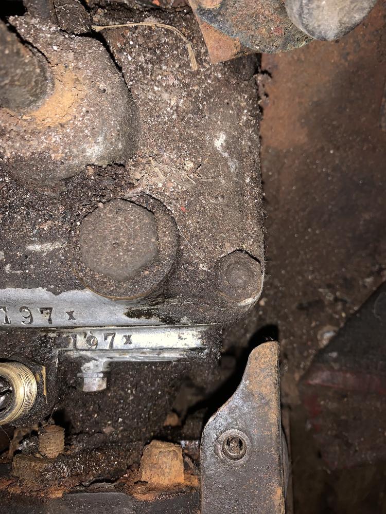

Some more numbers.
Gearbox  X197X  and matching top.

so for original largely undisturbed cars, the gearboxes do seem to be broadly respecting body sequence, allowing for replacements appearing in cars too, that takes them up into the 230s...

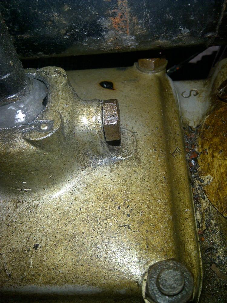

Regarding the gearbox - has it got the 'S' stamped on it - I may have missed it in this trail but a sports box should have an 'S' surely? I would clear away more of the grime to see if it is there.
Just found this old photo of my old car (no longer owned by me) showing the 'S' marking.

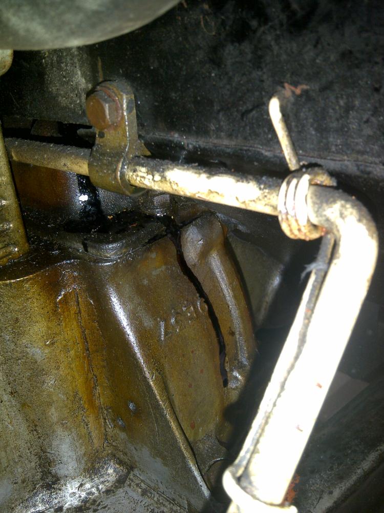

Another thing to check out - take a look at the throttle cross shaft mounts.  Picture here again showing sports mounts - are they on yours?

Damian - did yours have the X-digits-X markings too on edge of lid?
