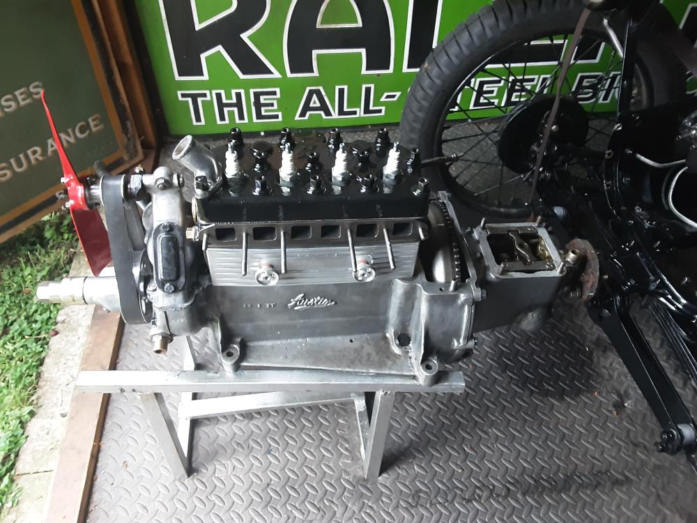

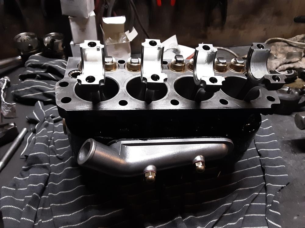

After a couple days of falling behind, today was a day to catch up a bit.
Though I'd open a new tube of gasket seal, as this is what I used last time. And everything sealed fine.
Most of the repaires and cleaning is done, so it's mainly build up. And settings.
Rods have had a new set of shells.
Pistons fitted etc.
All oiled as fitted.
And everything turning fine.
Sump gause, and sump can be fitted and sealed.
Tappets set at a slightly tight 8 thou across the board, and chest cover fitted.
Head gasket very lightly greased, as I usually do.
And head fitted and sealed.
Could do with at least the engine finished, and ready to fit tomorrow.
Tony

Engine is now together,
And waiting for the gearbox, so it can be fitted back in.

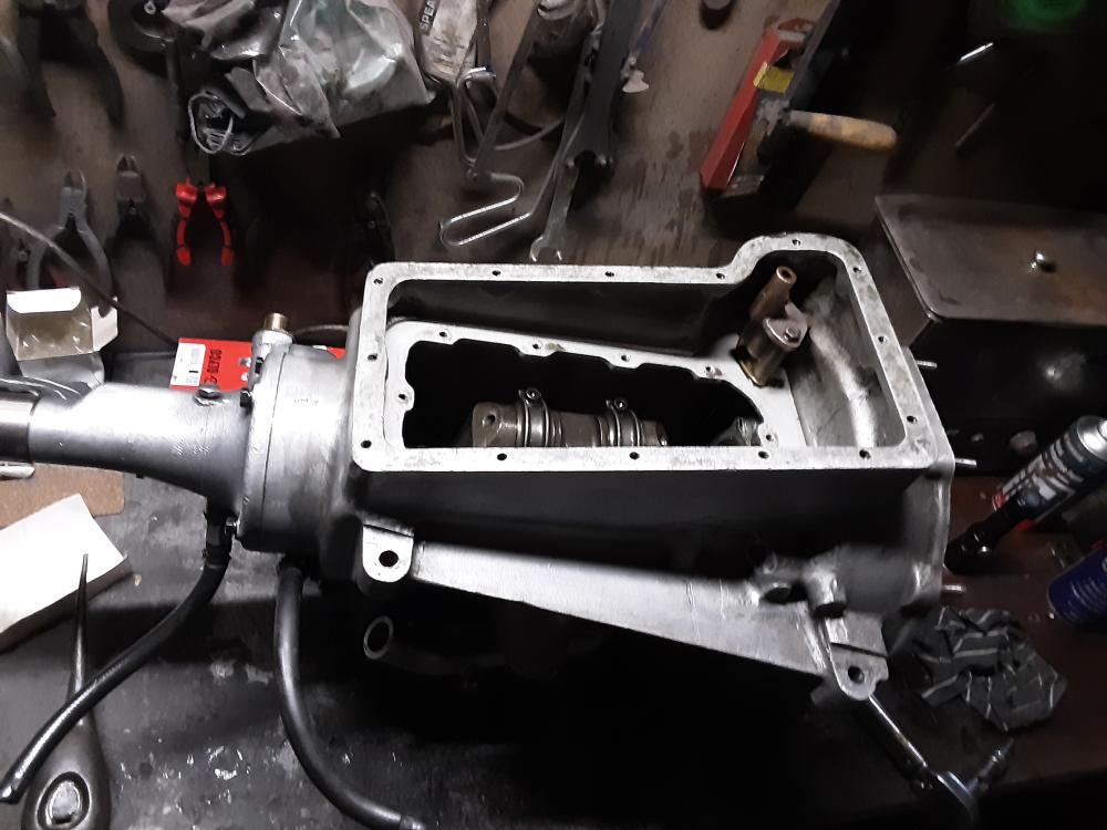

Started on the gearbox this afternoon.
The oil was a bit like toffee, so emptied that.

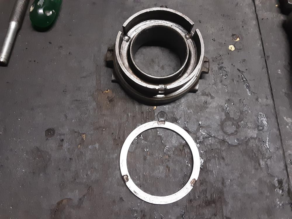

The clutch thrust is more of a problem.
It has a plate in it to take up the movement to the fingers.
This is something that is needed on these early clutch thrust bearings.
But I wish someone would make them with a bit more thought.
As you can see, the fingers end up running closer to the edge. As the fingers wear on the outer clutch plate.
They need to be laser cut, with 3 prongs for the fingers to sit on. Machined to fit the edges. And as important. Heat treated.
But I just dont have time this time round, so I've rotated it. And stuck it back in.

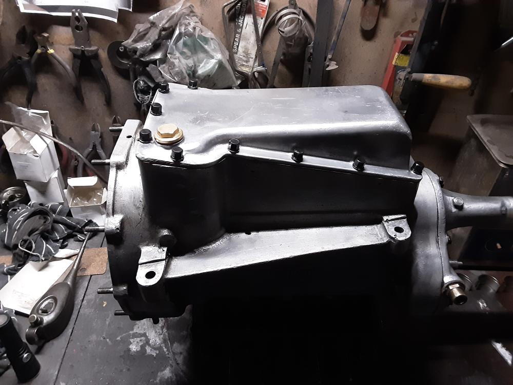

This was the gearbox and thrust is done, and fitted ready to go in one.
The propshaft had a split gate, so I've changed that.
Which put me onto the problem most people have with the gear lever.
As shown below. The wear splayed out. And also the bolt.
For starters, the bolt wasnt really long enough. And with the lock washer holding out even further.
So the wear is right on the tip of the bolt.
I've done this to show how much movement is in the lever.
