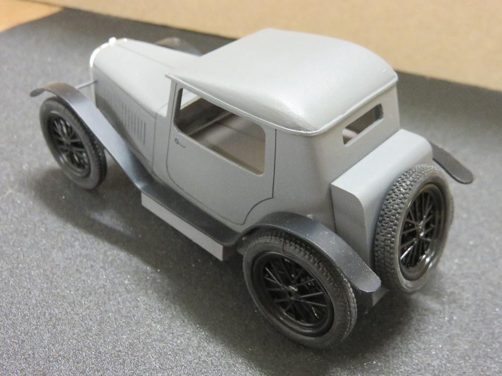

Once back in the workshop I scavenged some parts of an old Dixi scale model and put together a very rough sketch model. At this stage we were thinking the body would be narrow enough to fit between the rear wheels (as with an Ulster) to keep the cost and weight down. The model sat in the workshop and various visitors had a say in what they liked and didn't like. I also began to make measurements and realised the body was too narrow to be practical - Ulsters allow elbow room outside the body but a closed car wouldn't.
The first model was discarded and another equally rough second one put together. With this one I played around with types of wings, boot, colour schemes etc. The roof line was eventually changed to mirror an Austin saloon shape.
The lump on the back is a boot (with access through into the main body) as there is plenty of room under the bonnet for a petrol tank! Doors are suicide because of the sloping screen and, although we considered a vee-screen, on balance thought the aesthetics didn't justify the time involved. The wings will be similar in section to a G.E. Brooklands, the rad shell will be a '29-'30 type and the wheels 19".

I love the way you have let everyone discuss what should be before the grand reveal... as if you hadn't given it much thought!
In model form it looks stunning. Can't wait to see it take shape.

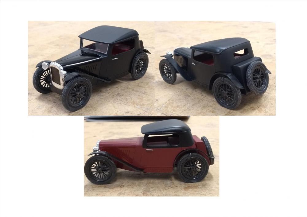

The proposed design looks great, I think it has the look of a mini Lagonda.   I thought that suicide doors would be the way to go,  I have them on the Pytchley.  They make maintenance a doddle, especially if you need to get behind the dashboard or mess about with the pedals.  I was a bit wary of suicide doors in case they opened at speed, but found some small flip over latches on Ebay which give added peace of mind.
Presumably the floorpan will be similar to a Type 65/Nippy?
From the side it looks a bit like a G*s*h*p*e* with a cosy hardtop!
It would also suit a Ruby type cowled radiator.
Look forward to seeing how it progresses.
As for colour schemes, it looks good in black.  Lord Howe had a GE Wembley in buff and marble blue with black wings.  A Highland Coupe needs Highland colours?
