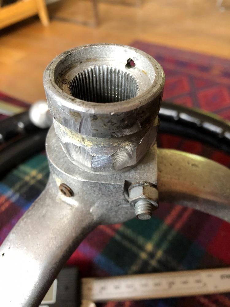

Neil discovered a rusty, probably irreparably Damaged
 Ruby steering wheel in his pile of old Austin bits.
So after soldering up my Scuttle petrol tank I
took a disc cutter to this old steering wheel and cut off the splined hub.
When the new spider casting comes back from JB Neil will
Use his lathe to machine down the splined part and then shrink
it into a pre bored hole in the new casting plus secure the two parts
with some grubs screws tapped in from the side of the hub.
In the meantime I’ve borrowed Neil’s Box Saloon type steering
Wheel so should he back on the road by the weekend!
Still to fix the dynamo and brake light switch though.
Regards
Bill G
Necessity being the mother of invention, good one Bill.
Why don't you simply repair your old steering wheel Bill? It could be welded and rebored or even weld in your splined insert if you prefer.
Hi Ian
It was badly welded before I bought it
And the clamp mechanism fractured it
further. I don’t want to risk it failing when
I am driving so happier with a solid engineered
solution.
I know others have had problems with these
early wheels.
Regards
Bill G
Back on stream after a long layoff on other projects Life, C19 and blocked drains
Neil has supplied an old Ruby wheel centre and is about to turn it down to insert
it as a sleeve inside an old stock repro deep dished wheel. Planning to fix it inside
the chunky hub of this wheel and fix it with loctite and two grub screws.
I may slot a bit of the spline? To help the clamp bolt?
I also need to take out the column before fitting as I need to add a small shim
to the steering box button To remove a bit of the slack.
