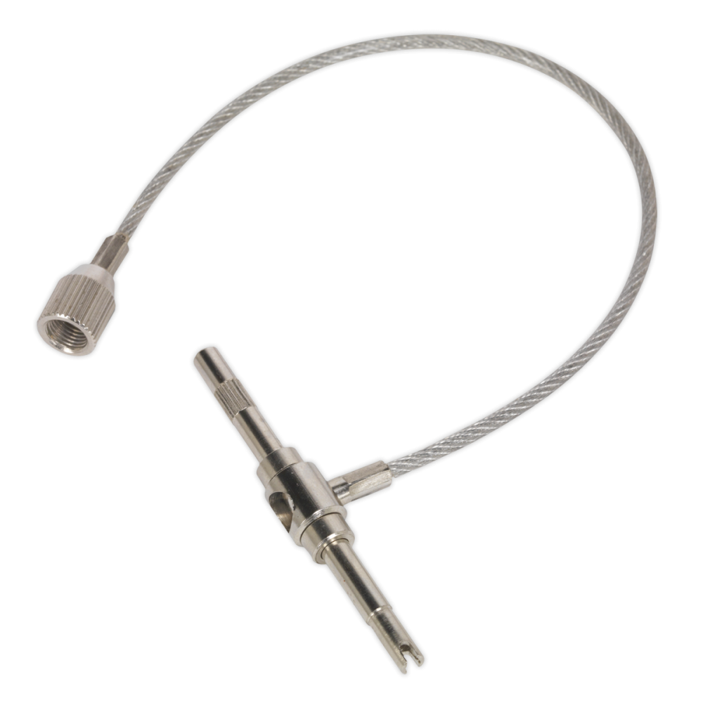

A few years ago a friend bought me this gadget for keeping valves correct and vertical when fitting new tubes and/or tyres. Simply thread the end onto the valve after inserting into the cover, and prior to trying to inflate; pull it into position and then inflate GRADUALLY all the while keeping an eye on the valve. It never fails. Problem is - I can't load a photo, and we don't know who the supplier was/is?...
#34
This or something like it Bob on eBay Sealey-Tyre-Valve-Fishing-Tool-
https://www.ebay.co.uk/itm/Sealey-Tyre-V...0041.m2061
#35
Ian, That's it exactly! Works a treat...

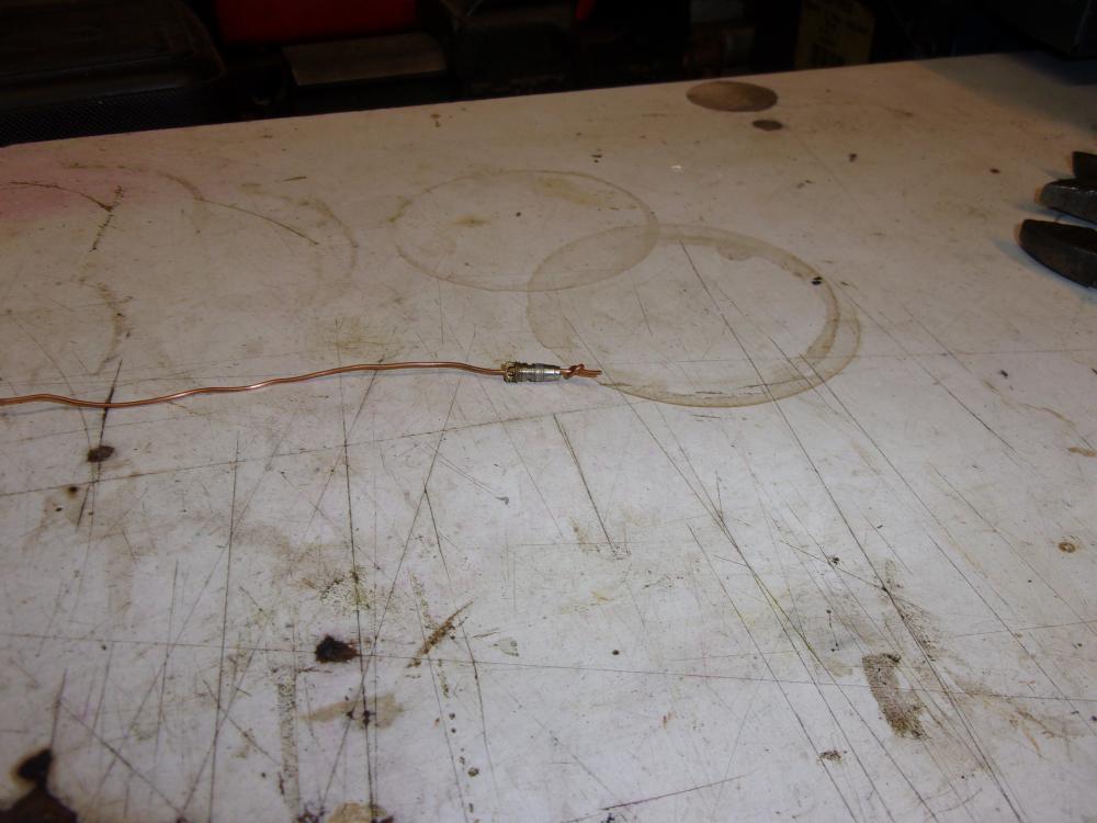

    When fitting the inner tube I find my fat fingers can't put the valve stem into the hole so I use an old valve on the end of a piece of wire to thread the valve stem into it's hole.
#37
That is nothing short of brilliant! Thanks, I'll make two tomorrow and put one in the car tool kit and one in the workshop toolchest.
#38
Indeed, that is inspired! Having just fitted 3 tyres and the back of my hands and fingers still bear the scars of getting the valve stem into the hole in the rim, like Duncan, I will be making a couple of these today!!
#39
presumably, combining the two ideas above, you could also make it with cord and a valve stem cap?
#40
That is the mark 2 version, the mark 1 used flexible wire which didn't work.
