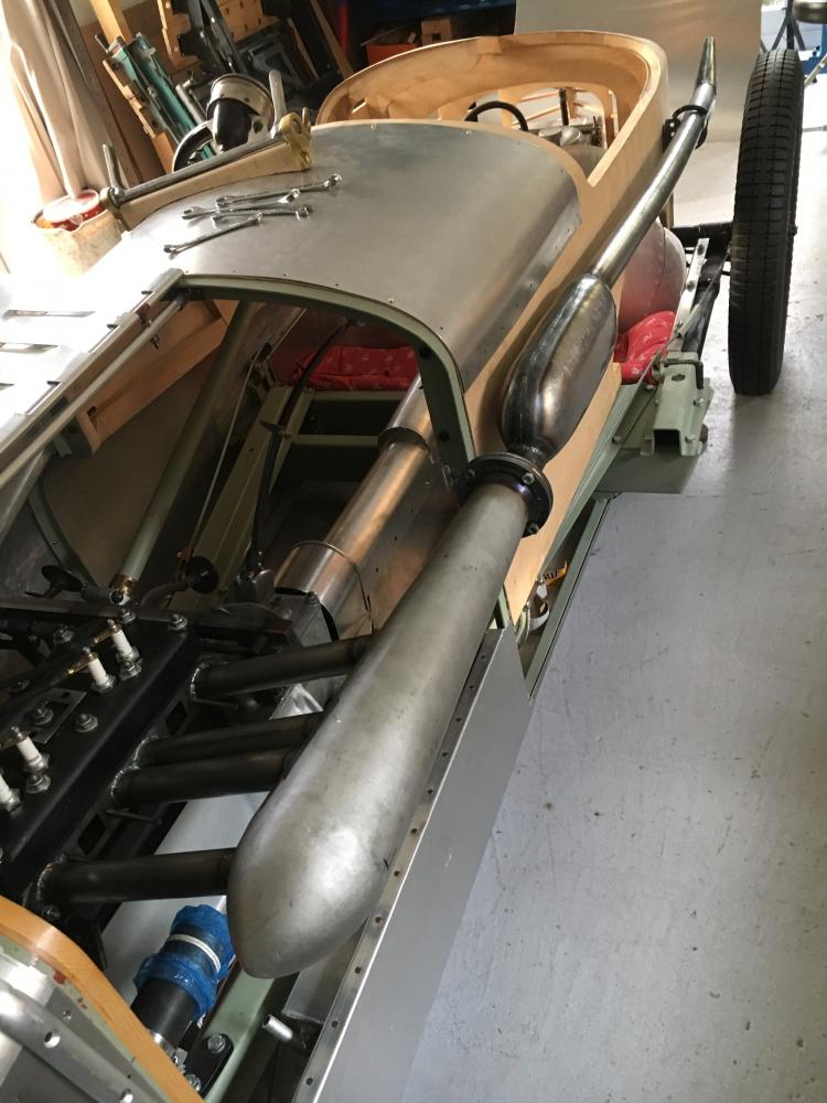

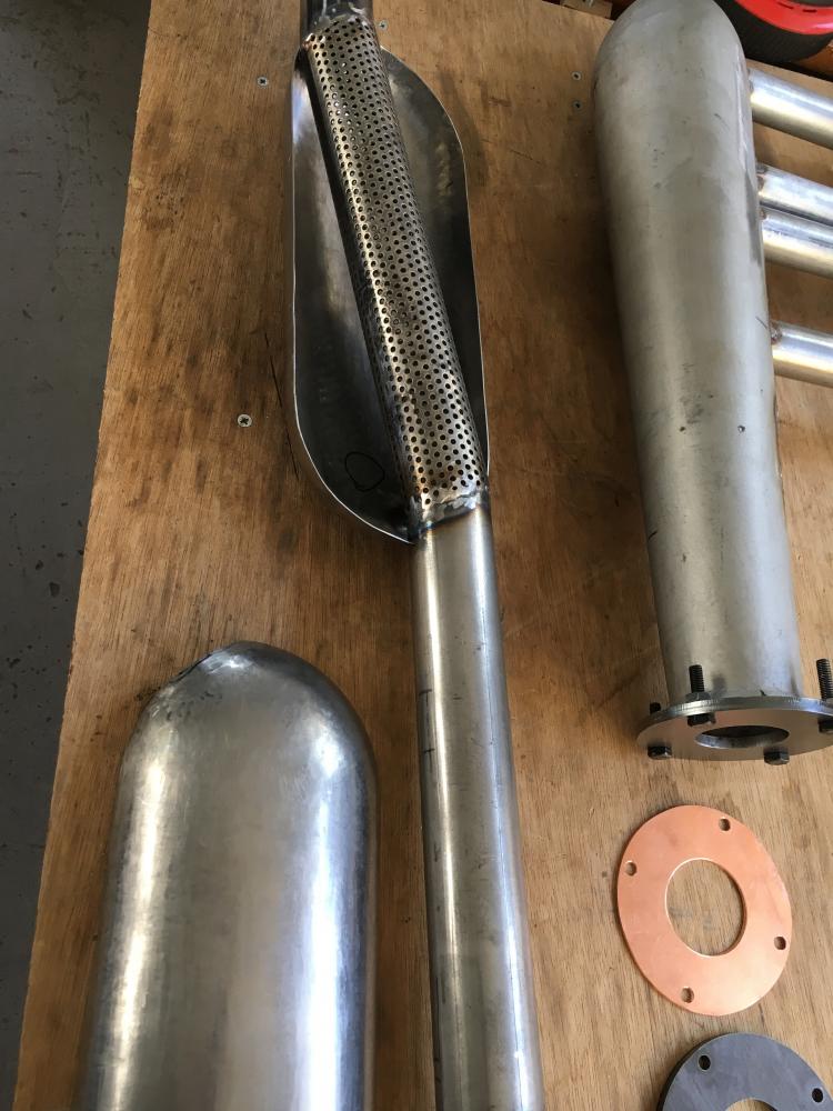

Since my last post on Slippery Anne, I have made some progress with her over the last few weeks, The manifold and exhaust is now finished, but awaiting paint, I really have no idea what to finish it with or if any particular colour was used back in the 20s.
I shaped the silencer out of mild steel and made it to the same dimensions I extracted from the period pictures, but, deviated from the baffle box approach, instead using a perforated tube and acoustic filling, which, if my sums are correct should enable the car to pass environmental scrutineering. The silencer input pipe is 1 3/4", which I think is correct to period, but, unlike the Brooklands rules exhaust used back in the day, I have increased the output pipe to also be 1 3/4" and finished it with a fish tail which has a nice big slot.
Another deviation from original is the mounting against the body. The original 1925 design was a simple clamp around the exhaust pipe which was hard mounted to the body, I have made a period looking mount with springs acting as a clamp to allow for body/chassis flex.
To attach it in the short term, I have gone for a simple flange to join the system up at the manifold, but, in the long term I intend to try and fabricate a more original settup using a large nut, which I assume was some sort of compression fitting!?
Regards, Mark.

That is all looking very impressive Mark, crack on!

Well I'm impressed Mark!
And yes, looking at contemporary pictures you realise that most specials of the 20's / 30's nowhere near approached the perfect lines of modern creations.

Hello Bill,
Understanding the benefits to setup of the car, I do not plan to run it on the road, but will use it for sprints and hill climbs, I am probably not going to race her. Having said which, I did make and fit a 2ltr oil catch tank, just in case!
If you want to reconsider that Mrs JoJo replica, I do have a 1926 chassis and bits..............
All the best, Mark.
(14-04-2019, 11:52 PM)Ian Williams Wrote: Always a pleasure to see your progress Mark, we can't be far away from hearing her run now?
Thank you Ian,
Yes, she is close to running, I do need to tighten up everything, as many parts of the car are only slotted together to aid their constant fit, removal and refit whilst making and fettling things.
Regards, Mark.
