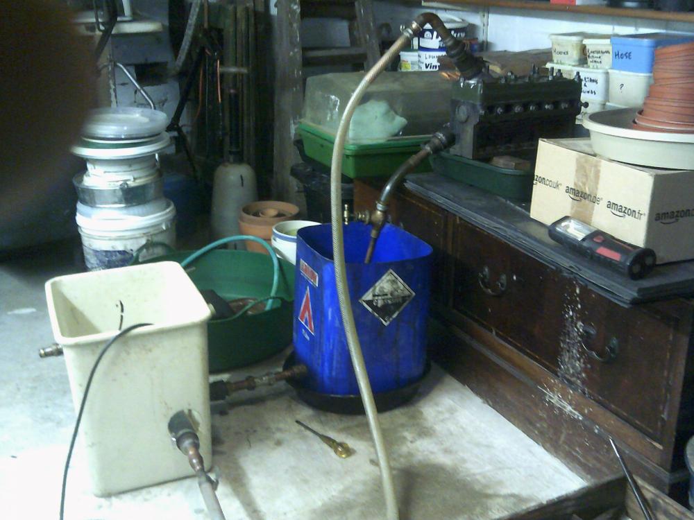

    Ah Charles your approach is similar to mine only mine is off the car using Deox C and a washing machine pump in the white container circulating the wrong way round. All the crud of which there is loads collects in the blue tank.

If I hook up a rig like Charles' I can find out whether flow is OK through the engine, and clean it out a bit at the same time.
Charles - do engines overheat running on your external water tank? how quickly do they get up to temperature? (clearly the water is not being cooled by a rad, but there's a lot more of it, and the engine can't be working that hard....)
#26
(12-02-2021, 11:45 PM)jamesheath Wrote: Charles - do engines overheat running on your external water tank? how quickly do they get up to temperature? (clearly the water is not being cooled by a rad, but there's a lot more of it, and the engine can't be working that hard....)
It will boil if you let it but you can stick your hand in and see when its getting hot.
It doesn't boil that quickly, even with a blown engine. You can also see the thermosyphon system working and the crud coming out of the top hose when you blip the throttle
