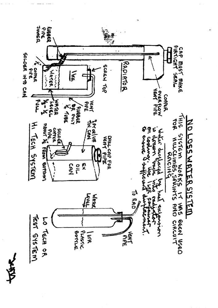

click on image for correct way up.
Try this it works,  Terry.
Looks like the system on the BMC 1100,s!
