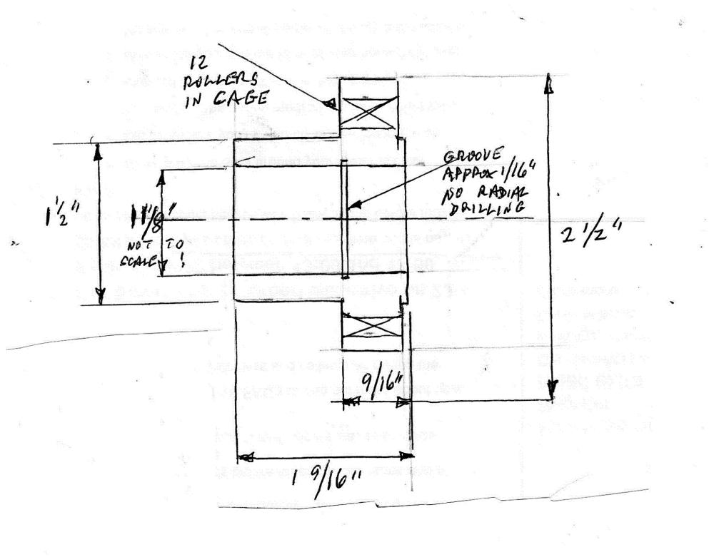

In my past experience, the ball bearings last for 40 - 50,000 miles. These days I do a max of 2000 miles per year so that's 20 - 25 years or more.
That'll see me (and probably the next owner) out.
I've never seen a spacer like that before, integral with the bearing. Usually, it's a separate piece. Has someone built something special here??
Joined: Aug 2017 Posts: 1,796 Threads: 44
15
I have never seen a roller bearing with an extended inner ring ???
I would think it unlikely that Austins would have had this made. The material does not look like bearing steel.
Not sure but something doesn't seen correct.
Getting back to the question- as suggested the ball bearing would probably do the job now although the roller is a better solution (as Austins found out).
You will need a new spacer as well.
Joined: Jan 2018 Posts: 60 Threads: 21
2
Well it was my mistake. The apparently extended inner race was actually the spacer which had worn into the bearing roller cage and the radius next toi the shaft on the inside of the inner race so that it was surprisingly well fixed and the joint inside looked like an oil groove. It did not come apart by knocking it laterally. I put it freely through my vice jaws and used a punch inside on the edge of the apparent oil groove and it fell apart. So apologies if you spent unnecessary time head scratching! Well I did as well.
The new pinion shaft unfortunately has a 1" diameter for the bearing instead of the original 1.125". It looks as if I will have to use the 1"/2.5" ball bearing as there does not seem to be a roller bearing available in that size. I am waiting for the shaft to arrive to see if I do need to have a new spacer made but you are probably right Tony.
95
Location: Auckland, NZ
01-03-2022, 11:40 PM
(This post was last modified: 01-03-2022, 11:44 PM by Bob Culver.)
The ball bearings were not long lived in hilly everyday use but the rating of modern bearings is much increased since the 1930s (hence tiny bearings in powerful moderns). An advantage of the roller is the pinion can be repeatedly withdrawn to check assy mesh but presumably the new cwp will com with a gauge so no trial and error. Ball race much less expensive.Mind you not sold a C3 toleracne bearing. Careful thought needs be given the spacer length to ensure everything appropraitely gripped when assembled.
Dont throw out the old cwp. Anything with teeth intact might be useable!
Joined: Aug 2017 Posts: 900 Threads: 50
4
Location: North Wiltshire
Car type: 1927 Chummy, 1938 Big Seven 1/2 a Trials Chummy
Ah! The old worn spacer problem.
This is usually the root cause of the nut apparently coming loose when the tab washer is undisturbed.
Beware of second hand spacers because i) There are two sizes, one for the ball race and one for the roller and ii) most of them are also worn. The spacers should be an exact imperial size (I can't remember what it is) so it's important to measure the length with a micrometer. Of course, if you're setting up a new CWP it doesn't matter so much if the spacer is 10 thou short as you can add 10 thou to the shims on the torque tube but it can get tricky if the spacer is very worn.
Joined: Aug 2017 Posts: 741 Threads: 8
11
Location: N W Kent
A 1/16" wall thickness steel sleeve Loctited (or shrunk) onto the pinion will allow you to use the late style roller bearing. The bearing in this position on the pinion is only taking radial load, so a roller bearing is always going to be far superior to a ball race for this job.
